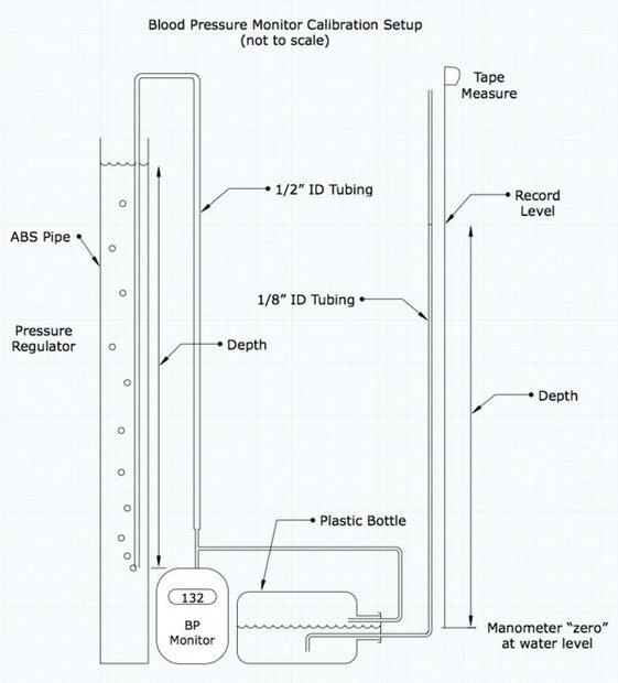

I've wanted to check the accuracy of my Blood Pressure Monitor (BPM) (an automated Omron unit), and finally found this old (2016) thread on another site (linked below). Prior to this, I only found the less helpful 'compare the reading to your Doctor's office' (BP varies with every reading, not so great), or 'send it to the mfg' (probably costs more than a new one!).
The author's goal was to rely on gravity and water, rather than another meter (with questionable accuracy). So this made some sense to me. He adjusts the water depth in the column on the left as a 'regulator' so that the BPM maintains a constant pressure so you have time to get a steady reading, rather than trying to catch it as it rises as it fills the cuff. Pretty clever, I think.
But then, why does he need the column on the right? Wouldn't the depth of water above the tube on the left indicate the actual pressure in inches water column? Just compare that to the reading on the BPM? I suppose the plastic bottle could be used (if needed) as a reservoir to smooth the pulses from what I think is a diaphragm pump (the air volume in the cuff might provide this in actual use)?
https://www.uglyhedgehog.com/t-378334-1.html
TIA - NTL2009
That is almost clever!
I would put the BP Monitor above the top of the tubing exiting the "Pressure Regulator" though. That reduces the risk of water entering the Monitor.
The basic theory is the pressure generated by Monitor increases the pressure in the bottle, thereby forcing water up the Manometer arm.
The tubing in the Pressure Regulator acts as a relief valve to limit the maximum pressure in the system. The pressure limit is set by the distance the end of the tubing is below the water level in the Pressure Regulator.
[Edit:]
I just realized that the Manometer arm and T-fitting are not needed.
The Pressure Regulator also serves as a Manometer.
  • Start with the tubing to the BP Monitor disconnected
  • Insert the tubing in the Pressure Regulator as shown in the drawing
  • Connect and start the BP Monitor
  • Measure the distance from the water surface of the Pressure Regulator to the water surface in the tubing that is in the Pressure Regulator
[/Edit:]
Hope this helps.
Cheers,
Tom

I believe that the reason for the right section is to eliminate the error introduced by the bubbles.
In aquariums, bubbles in a water column are used to pump water from an undergravel filter up to slightly above the surface of the aquarium.
The bubbling column of water has less density than the all-liquid column, reaching a higher level when in pressure balance.
Please, see:
https://animals.howstuffworks.com/pets/choosing-aquarium-equipment7.htm
Thanks for those replies. Yes, keeping the BPM above the level in the 'regulator' makes good sense, I didn't think of that!
Ahhh, the old bubble pump! I didn't think of that effect either. Hmmm, he uses a 3" diameter PVC and 1/2" hose, the 3" PVC would seem to reduce the magnitude of the effect.
The use of the 1/2" hose for the regulator (vs 1/8" for the manometer) he does mention is to reduce resistance, so pressure is about equal at the hose end and at the monitor, but I don't see why this matters - the tee to the manometer is near the BPM. It seems (within reason), that is all that matters if you aren't measuring from the regulator, but only using it to adjust to the target point. It also seems a simple adjustable valve would suffice - just set it to bleed off air until the BPM reads the target number, then read the manometer. Maybe a little more finicky to get set, but it eliminates a large PVC tube filled with water, which is kind of awkward.

Yes, I was also thinking about the accuracy/repeatability of detecting the start/stop of the pulses. I was expecting a microphone in the cuff, but it is just an air hose, so they are picking up the sound through that air hose and a microphone in the machine, which might be just fine. With the proper filtering and threshold detection, I'd think the machine *could* be (but not necessarily *is*) more consistent than a random sample of humans who do this task. But that's just a guess on my part.
:thumbup::thumbup::thumbup:
