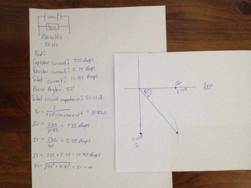

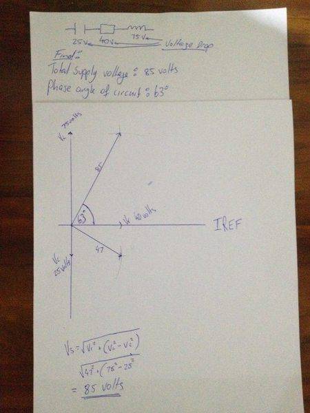

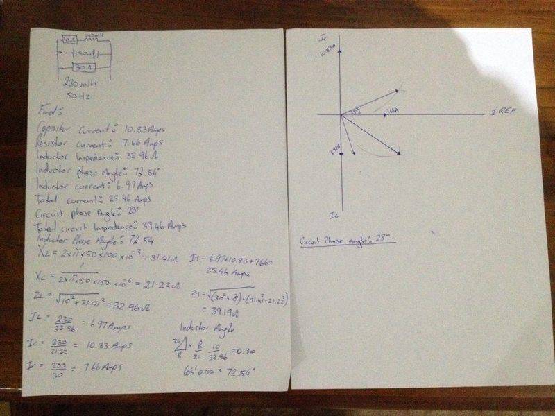

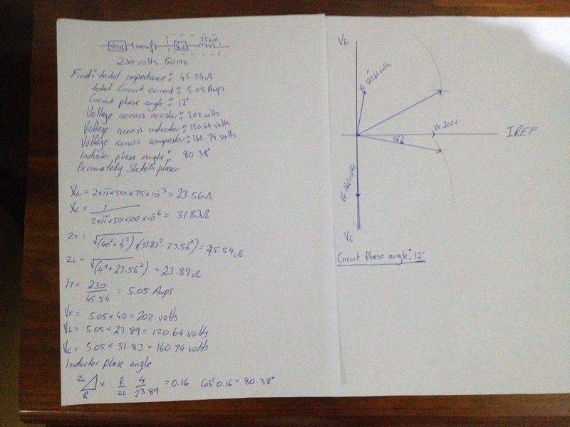

I have completed the questions in the attachment I just need someone to tell me if they are correct and I'm doing them right. Thanks.

Hi Basil, welcome to PF :smile: !
Interesting stuff, but hard to read. What are the questions ?
I think what you want isn't what PF is about. Please read the guidelines and tell me if I am all wrong.
Teacher will do what you are asking, so what is it you want from PF ?
