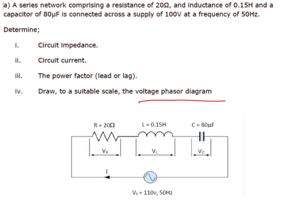

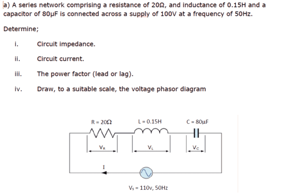

Hello.
I have completed the following question.
Circuit schematic of a series RLC network: resistor R = 20Ω, inductor L = 0.15H, capacitor C = 80μF, with voltage across each element (VR, VL, VC) and source Vs = 110v, 50Hz, current I shown.
My answer:
i)
Circuit Impedance
Reactance = XL = 2 x pi x F x L
= 2 x pi x 50 x 0.15
= 47.12 Ohms
Reactance of Capacitor = XC = 1/2 x pi x F x C
= 1/2 x pi x 50 x 80x10^-6
= 0.0006366 Ohms
Total reactance = XT = 47.12 - 0.0006366
= 47.119 Ohms
Z^2 = R^2 + XT^2
= 20^2 + 47.199^2
= 2,620.200161
Square Root of 2,620.200161 = 51.187 Ohms
Z = 51.187 Ohms
Theta = Tan^-1 (47.119/20) = 67 Degrees
ii)
Circuit current
Ohms Law
I = V/Z = 100/51.187
= 2.14 Ohms
0 Degree - 67 = -67 Degree
2.14 > -67 Degree
iii)
The Power Factor
PF = True Power / Apparent Power
R = Resistance
Z = Impedance
PF = CosTheta = R/Z
= 20/51.187
= 0.390
I have this so far. Trying to learn and complete this question. Once i know these answers are correct i will draw the phasor diagram.
Any help will be much appreciated.
I think i have done all this correct. Just asking to make sure i haven't made any mistakes.
Thanks

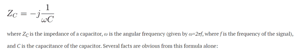

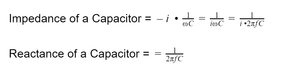

You made a mistake when you were calculating the reactance of the capacitor. The correct formula to find th reactance of a capacitor is:
Two equations: Impedance of a Capacitor = -i · 1/(ωC) = 1/(iωC) = 1/(i·2πfC), and Reactance of a Capacitor = 1/(2πfC).

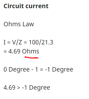

Also, when you are calculating the circuit current in (ii), the unit of current is in "Amperes" or just noted as "A" at the end of the current value.Just to confirm, is the voltage source 100V or 110V? In the diagram it says 110V, but in the problem statement, it says 100V.It's important to mention whether the Power Factor is leading or lagging. A "leading" power factor means that the current phase value (i.e. the current "angle") in the circuit is larger than the voltage phase value (i.e. the voltage "angle") in the circuit. That will help you when you are drawing the phasor diagram to know which one is leading/lagging the other.
  • Equation Z_C = -j (1/(ωC)) for capacitor impedance, followed by text defining Z_C, ω = 2πf, and C.

Thank you for your reply.
I had the reactance of capacitor formula correct.
I have calculated this. Is this correct? If not where have i gone wrong?
= 0.006283 Ohms
I will put A after circuit current
I will find out whether it is 100 or 110V
And the power factor is lagging.
Thank you for helping me.
Much appreciated.
= 0.006283 Ohms
Much appreciated.

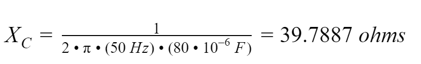

You are supposed to put the 2 * pi * f * C in the denominator.
It's supposed to be like this:
Equation: X_C = 1 / (2 • π • (50 Hz) • (80 • 10^-6 F)) = 39.7887 ohms
It seems that you plugged the equation into your calculator incorrectly by doing this:
Typeset equation: X_C = (1/2) · π · (50 Hz) · (80 · 10^-6 F) = 0.006283 ohms
I thought i was doing it wrong!
Thank you so much for that
i)
Circuit Impedance
= 47.12 Ohms
= 39.7887 Ohms
Total reactance = XT = 47.12 - 39.7887
= 2.3313 Ohms
Z^2 = R^2 + XT^2
= 20^2 + 2.3313^2
= 405.43
Square Root of 405.43 = 20.13 Ohms
Z = 20.13 Ohms
Theta = Tan^-1 (20.13/20) = 1 Degrees
ii)
Circuit current
Ohms Law
I = V/Z = 100/20.13
= 4.96 Ohms
0 Degree - 1 = -1 Degree
4.96 > -1 Degree
iii)
The Power Factor
R = Resistance
Z = Impedance
PF = CosTheta = R/Z
= 20/20.13
= 0.99
Is this now correct?
I have correct all by calculating the Z correctly
Your help is very much appreciated
i)
Circuit Impedance
= 47.12 Ohms
= 39.7887 Ohms
= 2.3313 Ohms
Z^2 = R^2 + XT^2
= 20^2 + 2.3313^2
= 405.43
Z = 20.13 Ohms
ii)
Circuit current
Ohms Law
I = V/Z = 100/20.13
= 4.96 Ohms
4.96 > -1 Degree
iii)
The Power Factor
R = Resistance
Z = Impedance
PF = CosTheta = R/Z
= 20/20.13
= 0.99
When you were calculating your Total Reactance:
= 2.3313 Ohms
It should actually be 7.3313 ohms.
i)
Circuit Impedance
= 47.12 Ohms
= 39.7887 Ohms
= 7.3313 Ohms
Z^2 = R^2 + XT^2
= 20^2 + 7.3313^2
= 453.74
Square Root of 453.74 = 21.3 Ohms
Z = 21.3 Ohms
Theta = Tan^-1 (21.3/20) = 1 Degrees
ii)
Circuit current
Ohms Law
I = V/Z = 100/21.3
= 4.69 Ohms
4.69 > -1 Degree
iii)
The Power Factor
R = Resistance
Z = Impedance
PF = CosTheta = R/Z
= 20/21.3
= 0.938
That was me putting in the calculator incorrect.
Thank you for notcing that.
The only thing is my degree correct in ii)?

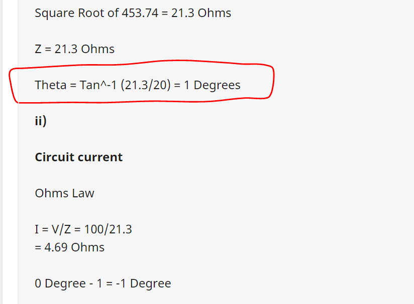

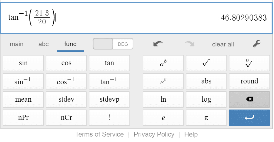

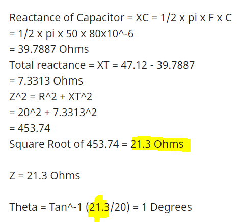

When you calculate your theta using tan^-1 (21.3 / 20), you get 1 degree:
Handwritten-style typed working showing Square Root of 453.74 = 21.3 Ohms, Z = 21.3 Ohms, Theta = Tan^-1(21.3/20) = 1 Degrees circled in red, then circuit current I = V/Z = 100/21.3 = 4.69 Ohms and 0 Degree - 1 = -1 Degree.
When I plug in tan^-1 (21.3 / 20), I get 46.80 degrees (Please see screenshot below):
Online calculator screenshot in DEG mode showing tan^-1(21.3/20) with the result = 46.80290383.

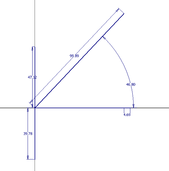

View attachment 263225When I plug in tan^-1 (21.3 / 20), I get 46.80 degrees (Please see screenshot below):
Actually, sorry I made a mistake.
Please see the file I attached at the bottom of this post (PF calculation.pdf attached). This file shows the full work of the problem that I did. Your reactance calculations (for the inductor and capacitor) are correct. It's just that you made a mistake when you calculated the impedance angle.

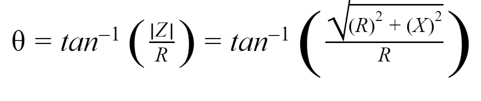

When you are calculating your impedance angle, you are meant to use the Imaginary part of the Impedance divided by the Real Part of the Impedance and then do the tan^-1 of that (You can see the calculation in the file I attached containing my work).
However, you are using the "Magnitude" of the impedance in your solution:
Handwritten-style calculation of capacitor reactance and total reactance for an RLC series circuit, ending with Z = 21.3 Ohms and Theta = Tan^-1(21.3/20) = 1 Degrees, with 21.3 highlighted in yellow.
Essentially, you calculated the impedance angle this way:
Equation: θ = tan^-1(|Z|/R) = tan^-1(√((R)^2 + (X)^2) / R), with the arctangent arguments shown in large parentheses.
The correct way to calculate the impedance angle is this way:
Equation: θ = tan^-1(Imaginary / Real) = tan^-1(X/R), with the Imaginary/Real fraction in parentheses.
Also, when you are calculating your Power Factor, it is better to use the equation that has the Voltage and Current Angle:
Equation: PF = cos(Φ) = cos(Voltage Angle − Current Angle), written in italic text.
That way, you will know immediately if the Power Factor is "leading" or "lagging". If the phase of the current (i.e. current angle value) is larger than the phase of the voltage (i.e. voltage angle value), that means you will immediately know it is a "leading" PF. However, if the current angle value is lower than the voltage angle value, then that means you know its a "lagging" PF.
This PF equation you used is also correct:
Equation: PF = cos(Φ) = R / |Z|, power factor defined as cosine of the impedance angle equal to resistance divided by impedance magnitude.
However, it doesn't tell you whether the PF is leading or lagging like the other equation.Also, please remember to put the correct units. I noticed you used "Ohms" when you were calculating your circuit current. I'm assuming you're in undergrad taking a Power Systems/Intro to Circuits course. Your professor/TA will definitely mark you down for this so be careful.
Handwritten-style worked step: Circuit current, Ohm's Law, I = V/Z = 100/21.3 = 4.69 Ohms (Ohms underlined in red), then 0 Degree - 1 = -1 Degree, and 4.69 > -1 Degree.
Once you make these corrections, you will be able to draw your phasor diagram.

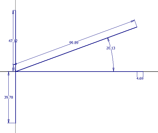

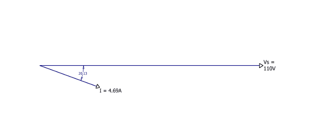

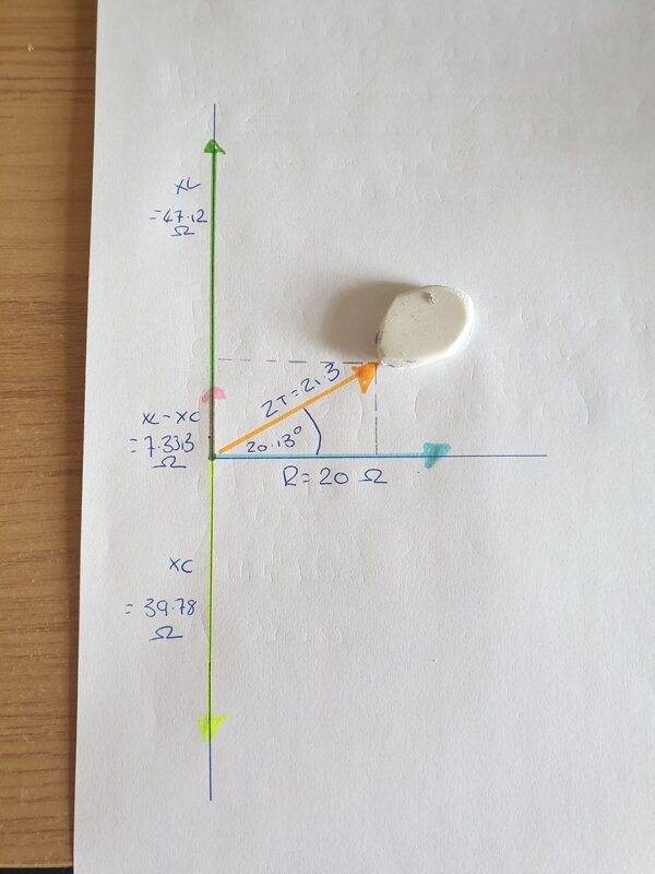

Thank you for that. I am now a little confused. But think i have it below:
I just need some help with the phasor diagram please. I have most of it complete. Just need help finishin git.
i)
Circuit Impedance
Reactance:
XL = 2 · π · F · L
= 2 · π · 50 · 15
= 47.12 Ohms
Reactance of Capacitor:
XC =
= 39.7887 Ohms
Total Reactance:
XT = XL – XC
= 47.12 – 39.7887
= 7.3313 Ohms
Z2 = R2 + XT2
= 202 + 7.33132
=453.74
= 21.3 Ohms
Z = 21.3 Ohms
Z = (R) + I (x)
Z = ((20) + I (7.3313))
IZI =
= 21.30
ii)
Circuit Current
Ohms Law
tan-1 ()
= tan-1
θ = 20.13°
I =
= 4.69 Ohms
Circuit Current = I = (4.69)(-20.13°) A
iii)
The Power Factor
PF =
R = Resistance
Z = Impedance
PF =
= 0.938
Lagging due to XL > XC

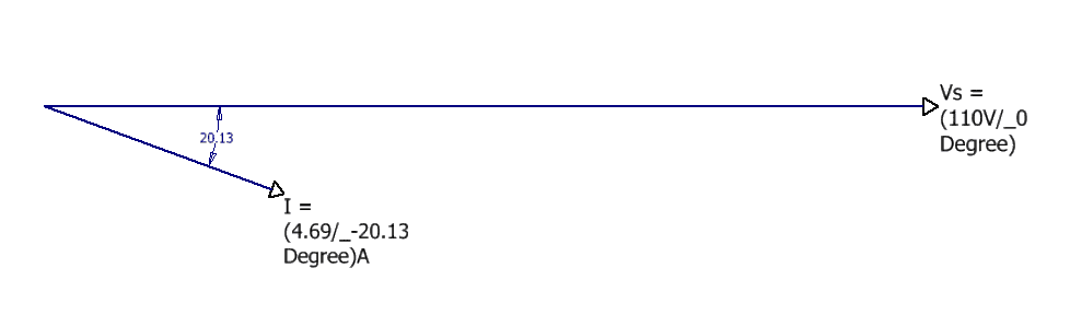

iv)

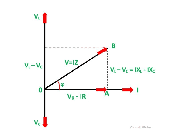

Phasor Diagram
Phasor diagram of a series RLC circuit: current I drawn horizontally, VR = IR along it, VL minus VC = IXL minus IXC vertical, and total V = IZ as the hypotenuse at angle φ from I.
Phasor diagram with a horizontal reference line; a vector of length 99.89 at an angle of 20.13 degrees above it, with the 4.69 and 47.12 and 39.78 component labels marked on the axes.
  • Phasor diagram with a horizontal reference line and a vertical line marked 47.12 above and 39.78 below the origin; a bold blue phasor at 46.80 degrees from the horizontal is labelled 99.89, with a 4.69 projection on the horizontal axis.

iv)
Phasor Diagram
View attachment 263511View attachment 263512
Is there something I can clear up so you're not confused anymore? If you do have any questions please do ask so I can clear them up.
Otherwise, here are some good Phasor Diagram examples you can learn from:
If you go to this link, there is an example of an RLC Circuit (on Page 9 / 18 on the PDF link).
https://www.philadelphia.edu.jo/academics/fobeidat/uploads/Electric Circuits II Course/5 Phasor diagram.pdf
Here's also an example of an RLC Circuit Example on Youtube:

My attempt at Phasor Diagram after looking at the links you gave. How does this look?? And if I have, where have I gone wrong. Only think I was unsure about is the current added on to he resistor.
Handwritten phasor diagram on paper: a vertical axis labelled XL = 47.12 Ω at top and XC = 39.78 Ω at bottom, with XL - XC = 7.338 Ω marked; a horizontal resistance R = 20 Ω; and a resultant Z_T = 23 at an angle of 20.18° from the horizontal.
Just to confirm, in the problem statement that you posted, it says draw the "voltage phasor diagram" (screenshot below):
Screenshot of a homework problem: part a asks for circuit impedance, current, power factor (lead or lag), and a voltage phasor diagram for a series R, L, C network, with a circuit schematic showing R = 20Ω, L = 0.15H, C = 80µF, and a supply Vs = 110V, 50Hz.
Is this the original problem statement or is there another question asking you to draw the full phasor diagram for the AC circuit?
  • Text problem with a series RLC circuit diagram: R = 20Ω, L = 0.15H, C = 80µF, supply Vs = 110V, 50Hz, with voltages VR, VL, VC and current I marked.
No this is the original problem statement. I just did not read it correctly.
Ok then in that case you should only draw the voltage phasor diagram. Heres another example of a series RLC Circuit:
Remember when you only draw the voltage phasor diagram, you need to know if the current is leading or lagging the voltage and by how much it is leading or lagging (i.e. the angle value)
Thank you.
I have drawn a Voltage Phasor diagram below.
Phasor diagram with a horizontal voltage phasor labelled Vs = 110V pointing right, and a current phasor labelled I = 4.69A at 20.13 degrees below it, measured from the horizontal axis.
Just to confirm, I have noticed that some conventional voltage phasor diagrams include real and imaginary impedances. I'm assuming you are taking this class in undergrad. Has your professor gone over voltage phasor diagrams? Does your professor/TA require you to include certain parameters in your voltage phasor diagram.
From what I can see, you just need to clearly indicate the magnitude and phase for the voltage and current (Even if it is 0 degrees, you need to write it). So for example, your voltage will need to clearly be written as (110/_0°) Volts and your current needs to be clearly written as (4.69/_-20.13°) A. Otherwise, I think it's correct. You also show which one is leading/lagging the other with the correct angle drawing (Showing the current 20.13° below the voltage).
So please double check that your professor/TA doesn't require you to include any impedances in your voltage phasor diagram. From my understanding, for a voltage phasor diagram, you don't include the impedances (Like you would for a full phasor diagram). If anyone else may have comments on this, please do include them.
Hello,
I think it is just the voltage diagram as i have done. I will show them and see what they say. I am a undergrad yes.
So my answer:
i)
Circuit Impedance
Reactance:
XL = 2 · π · F · L
= 2 · π · 50 · 15
= 47.12 Ohms
XC =
= 39.7887 Ohms
Total Reactance:
XT = XL – XC
= 47.12 – 39.7887
= 7.3313 Ohms
Z2 = R2 + XT2
= 202 + 7.33132
=453.74
= 21.3 Ohms
Z = 21.3 Ohms
Z = (R) + I (x)
IZI =
= 21.30
ii)
Circuit Current
Ohms Law
tan-1 ()
= tan-1
θ = 20.13°
I =
= 4.69 Ohms
iii)
The Power Factor
PF =
R = Resistance
Z = Impedance
PF =
= 0.938
iv)
Phasor Diagram
Phasor diagram with Vs = (110V/_0 Degree) drawn horizontally to the right, and I = (4.69/_-20.13 Degree)A drawn at 20.13 degrees below it, with the angle marked.
Thank you soo much for your help!
Hello,
So my answer:
i)
Circuit Impedance
Reactance:
XL = 2 · π · F · L
= 2 · π · 50 · 15
= 47.12 Ohms
XC =
= 39.7887 Ohms
Total Reactance:
XT = XL – XC
= 47.12 – 39.7887
= 7.3313 Ohms
Z2 = R2 + XT2
= 202 + 7.33132
=453.74
= 21.3 Ohms
Z = 21.3 Ohms
Z = (R) + I (x)
IZI =
= 21.30
ii)
Circuit Current
Ohms Law
tan-1 ()
= tan-1
θ = 20.13°
I =
= 4.69 Ohms
iii)
The Power Factor
PF =
R = Resistance
Z = Impedance
PF =
= 0.938
iv)
Phasor Diagram
So like I said in my previous post, please also double-check with your colleagues/professor because some professors might teach this in a different way. But as far as I know, for a voltage phasor diagram, this should be fine because you don't need to include impedances.
One thing you can also do just to make sure you understand how you arrived at the final voltage phasor diagram, is to draw the individual voltage phasor diagrams for each component in the circuit. So the voltage for the resistor, inductor, and capacitor, you draw the phasor for each one, and then add them to get to the final 110 V (0 degrees). Same thing with the individual current phasors. You draw each of them and show how you added them up to get to the final circuit current phasor.
