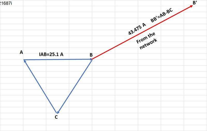

The loaded current it is 25000/0.8/√3/415=43.475 A
Actually this is the current from the network. The current in the motor winding in triangle it is only 25.1A, indeed.

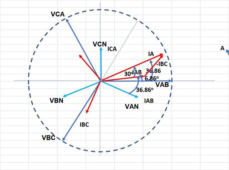

In my opinion, the power factor and Xs are calculated from the network point of view so for an equivalent star motor. In this case the current IA= 43.475 A and is leading the phase-to-neutral voltage VAN with φ= 36.87 degrees. Then the voltage drop [total] is IA*[cosφ+jsinφ]*jXs and the reactive part is jIA*cosφ*Xs.
The vectorial diagram it could be like this one:

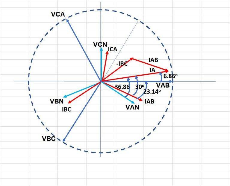

My mistake. The voltage considered for equivalent motor is not
“the leading the phase-to-neutral voltage” as I said but the phase-to-phase voltage. So, the vectorial diagram on the trigonometric circle it has to be like this:
