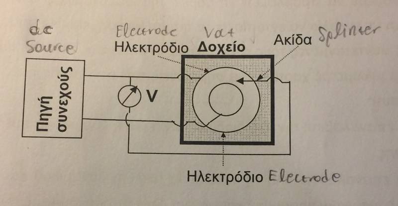

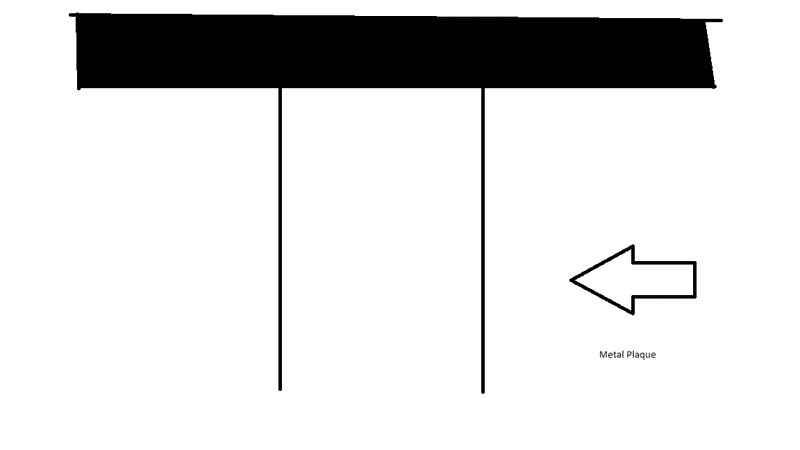

Alright, this is a Lab Exercise, so it's light on an actual introduction and data, but I'll do my best to put into words the whole thing. The gist of it is that we have a Vat with water, a millimetre paper at the bottom, and we put two Equipotential surfaces inside. We charge them, and then we take the splinter and measure the V in various places. Here's the "default" version:
Version One: Metal Plaques
As an FYI, it's about 10cm between the plaques, and we measure 5cm on the left, and 5cm on the right, outside of the plaques.
First up, we have to take measurements of V across the x = 0 line (meaning left and right only), outside of the metal plaque on the left, between the two plaques, and outside the metal plaque on the right. Here are the findings:

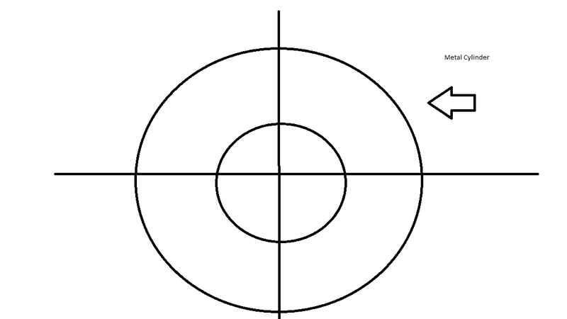

Version Two: Metal Cyllinders
Again an FYI, from the center (it's why I drew the x/y axis, to make it clearer, the cross is not part of the "ensemble"), it's about 5cm from each side till we hit the small circle, then 7cm until we hit the big circle, and then we take measurements 5cm outside of it.
In the second version, we do exactly the same things. But, due to the symmetry, we technically only had to measure one side (we chose the right on the First Exercise with the x-axis) and quarter(the one with a certain V; this time we measured the right and down quarter). So, for the V Measurements, we have:

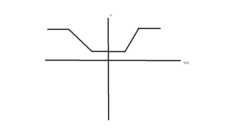

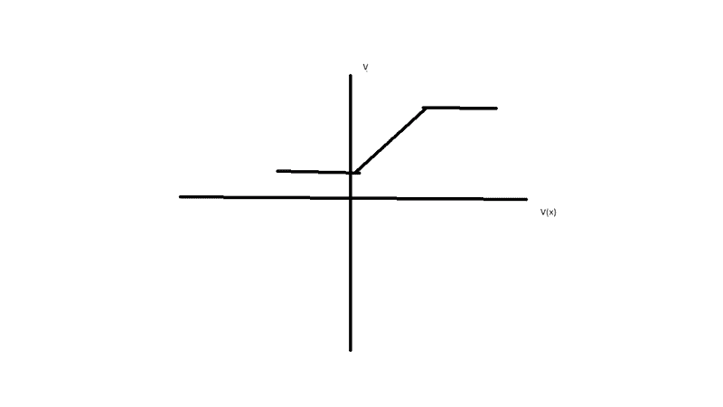

First up, we have the V=V(x) ones.
This is for the Plaques.
This is for the Cylinders.
For starters, can someone tell me what the graph "means"? Is it just a representation of the correlation of Voltage and the distance? As if we're saying V=f(x)? It's a tad of a silly question, but my book doesn't have Graphs.Then we have E=E(x).

From what I gather, E is kinda like the a to the u when talking about velocity and acceleration. So if say, u is stable, then a is 0, and if u is rising steadily, then a is stable. My problem is that the leaflet's instructions on constructing the E=E(x) are:
"Construct the V=V(x) graph. Be careful, V on top of the conductors (metal plaques/cylinders) is entirely different than in the water (sidenote: the vat contains water). This spot constitutes a spot ofdiscontinuity on the graph. From the sloop of the graph, by bringing the tangent on various places, compute the Electric Field E and construct the E=E(x) graph."
From what I'm getting, he means that I should go to each "section" of V, find the sloop if it's decreasing/increasing, mark that as E, or if it's stable mark E as 0, and the construct a graph that looks like the ones above.

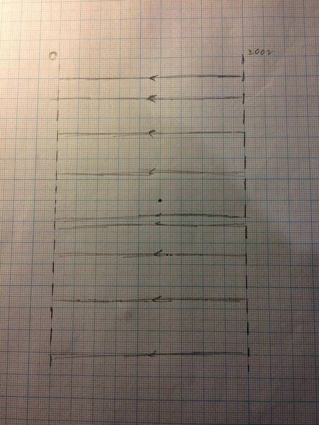

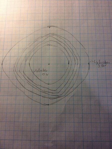

As for drawing/sketching the Equipotential Surfaces & Dynamic Lines, I whipped up some 1-minute "graphs" (no numbers and whatnot, just basic drawings) just to see if my thinking is correct (the Surfaces are the dotted lines, and the Dyanmic Lines are the "straight" black ones):
What I'm curious about here is; the book says that all Dynamic Lines are perpendicular to the surfaces, going from Positively Charged, to negatively. So, like the pic above. However, the Professor told us that the Dynamic Lines would be "parallel" to the Equipotential Surfaces, which I don't see how it works. Did he just make a blunder or am I missing something?
