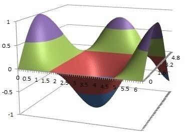

1. Homework Statement
f(g,h) such that g is a function of x and h is a function of y then how can i plot a graph in exccel
Make a row of of y values and a column of x values
Make a table of f(x,y)
(Excel 2010:) Insert tab | Other Charts | Surface
(Excel 2003:) Click Chart wizard | Surface
Example: x and y from 0 to ##2\pi## in steps of 0.1. ##\ \ g = \sin(2x/\pi),\ \ h = \cos(3y/\pi),\ f = g * h ##

can you please send me the detailed steps if possible ?
