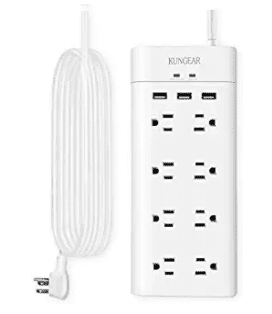

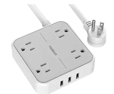

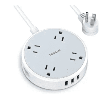

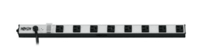

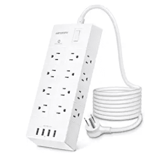

LightningInAJar said:
Like a 1/2" between the outlets would be fine.
There are many types of power cords, some of them with decent outlet-to-outlet distance. I would rather try a different (maybe a modular) one than make some kludge with a jungle of unnecessary cables.
I sympathize. The spacing between outlets can be maddening, when combined with the size and shape of some devices. The reason for the ban, as others said, is the risk of drawing too much power in total.
A better solution is to find extensions that have better arrangements of outlets or increased spacing. Here are a few I found with a quick search. Note that some include USB charging ports as well as regular outlets. Those can eliminate the need to plug USB chargers into the outlets.
