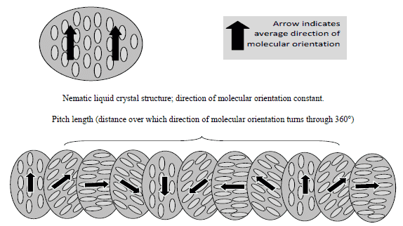

If light passes into a birefringent material with constant fast and slow directions, ##\hat{x}## and ##\hat{y}##, that are oriented the same way at any point in the crystal, then the electric field is$$\vec{E}(z,t) = E_0\hat{x}\cos{(\theta_0)}e^{i\omega(t - \frac{n_x}{c}z)} + E_0\hat{y}\cos{(\theta_0)}e^{i\omega(t - \frac{n_y}{c}z)}$$if the electric field is initially oriented at ##\theta_0## to the ##\hat{x}## axis before it enters the crystal. For a chiral nematic crystal, the fast and slow directions are functions of position, i.e. ##\hat{x} = \cos{(\mu z)} \hat{x}_{0} + \sin{(\mu z)} \hat{y}_0## and ##\hat{y} = -\sin{(\mu z)} \hat{x}_{0} + \cos{(\mu z)} \hat{y}_0##, where ##\mu## is just a constant. I want to find an expression for ##\vec{E}(z=w)##, where ##w## is the length of the crystal.
I'm not really sure what the best way to go about this is. I thought to try and split the crystal into ##N## slices of width ##w/N##, with lower faces at heights ##z_n = nw/N, n \in [0,N-1]##, and ##\hat{x}_n = \cos{(\mu z_n)} \hat{x}_{0} + \sin{(\mu z_n)} \hat{y}_0## and ##\hat{y}_n = -\sin{(\mu z_n)} \hat{x}_{0} + \cos{(\mu z_n)} \hat{y}_0##. Hence, the electric field at height ##z_1## would be$$\begin{align*}

$$and then between ##z_1## and ##z_2##, these two components will propagate at two different speeds along the ##\hat{x}_1## and ##\hat{y}_1## directions, so we need to write another equation for this layer, and so on. I really don't know if I'm going to get anything useful out of this, so I wondered if someone could let me know if there is a better approach? Thanks

Pardon my slightly "flip" answer earlier but I could not resist and it had some germ of truth. Of course the layer approach might work but you need to keep track of all the internal reflections backwards and forwards at the boundaries. I think it very difficult.
I note that you are imposing a periodic ##length=2\pi/\mu## condition with the chirality and I think something more like Bloch waves may be more reasonable.

lol, no worries! It made me smile. Anyway, yeah, my ##2\pi / \mu## is the 'pitch' of the crystal. I wonder, how would one go about using Bloch waves in this context, I've only come across them in the context of electron wave-functions in lattices?
It's not particularly important that I get the solution, I was more just playing around with it and trying to understand how a liquid crystal display works a bit more quantitatively :wink:
OK so I took a look at wikipedia and now realize I don't understand what the pitch has to do with it ( or if it does.) You do understand the fundamental rotation angle of the plane of polarization because of "normal" birefringence? (it goes like ##(k_{ordinary}-k_{extraordinary})z##. After that I am unsure...
This is roughly the type of arrangement I'm thinking of, my ##z## axis lies horizontally:
The director, and thus the fast and slow axes, rotate with increasing ##z## through the crystal, so the distance ##\Delta z## for one complete rotation in the orientation of the lattice planes is ##2\pi / \mu##, where I defined ##\mu## to be the equivalent of my wavenumber, i.e. ##2\pi / \mu## is the distance after which the structure repeats itself, one pitch.
