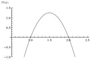

(a) If \(h<rK/4\) shows that Eq.(ii) has two equilibrium points \(y_1\) and \(y_2\) with \(y_1<y_2\); determine these points.
My work,
\(\displaystyle f(y)=\frac{dy}{dt}=r(1-\frac{y}{K})y-h\)
\(\displaystyle ry(1-\frac{y}{K})-h=0\)
\(\displaystyle -\frac{ry^2}{K}+ry-h=0\)
\(\displaystyle y^2-yK+\frac{hK}{r}=0\)
\(\displaystyle y^2-yK=-\frac{hK}{r}\)
\(\displaystyle y^2-yK+\frac{K^2}{4}=\frac{K^2}{4}-\frac{hK}{r}\)
\(\displaystyle (y-\frac{K}{2})^2=\frac{K^2}{4}-\frac{hK}{r}\)
\(\displaystyle y-\frac{K}{2}=\sqrt{\frac{K^2}{4}-\frac{hK}{r}}\)
\(\displaystyle y=\frac{K}{2}\pm\sqrt{\frac{K^2}{4}-\frac{hK}{r}}\)(b) Show that \(y_1\) is unstable and \(y_2\) is asymptotically stable.
This part is giving me some trouble. I think I would just calculate the second derivative of the original diff.eq and then you would plug in the two points found just above right?
Any help would be appreciated!
I agree with the equilibrium points you have found:
\(\displaystyle y_1=\frac{K}{2}-\sqrt{\frac{K^2}{4}-\frac{hK}{r}}\)
\(\displaystyle y_2=\frac{K}{2}+\sqrt{\frac{K^2}{4}-\frac{hK}{r}}\)
Now, regarding the stability of the equilibrium, consider that the phase plot will look something like:
Disregard the actual numbers on the axes, just consider that the plot of \(\displaystyle \frac{dy}{dt}\) is a function of $y$ and has two positive roots (the equilibrium points) and is parabolic, opening downward.
Can you tell by looking at the plot how \(\displaystyle \frac{dy}{dt}\) will behave near these equilibrium points?
For example, look at $y_1$, the smaller root. Below this root, in what direction are the solutions going? How about above this root? In both cases, are they being attracted to or repelled away from this point?
