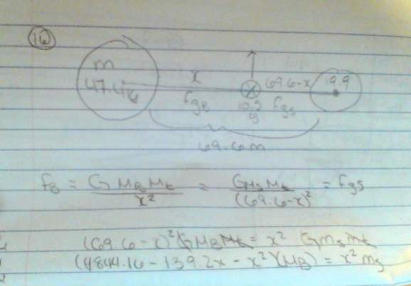

M1 is a spherical mass (47.4 kg) at the origin. M2 is also a spherical mass (19.9 kg) and is located on the x-axis at x = 69.6 m. At what value of x would a third mass with a 10.5 kg mass experience no net gravitational force due to M1 and M2? The attempt at a solution
https://mail.google.com/mail/?ui=2&ik=2ce981a95c&view=att&th=1338feddbcf78489&attid=0.1&disp=inline&realattid=f_guuf8isl0&zw
I think I'm on the right track, but I'm not really sure. And I'm not 100% sure how to simplify what I have. Any advice would be much appreciated.
Hi Becca93! :smile:
If your third mass is at position x, what would be the force with which M1 attracts the third mass?
And what would be the force with which M2 attracts the third mass?
(I'm missing a relevant equation here...)

After I got the answer incorrect the first time, loncapa gave me the hint "The force due to M1 must be of the same magnitude as the force due to M2, use Newton's law of gravitational attraction. "
This leads me to believe that the third mass must be between the two larger masses in order to experience no net gravitational force. Also because it talks about being on the x-axis and asks for the value of x. I'm just not sure how to go about solving for x, if you know what I mean.
Due to the hint, I think I'm supposed to set it as equal, but I'm really not sure.

Yes, you're supposed to set it as equal.
And before you can solve for x, you first need to set up the equation...
Can you set up the equation?

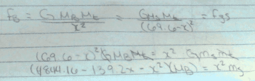

I don't know if the picture in the post above came out or not, but the attached photo is as far as I got equation-wise.
  • Handwritten derivation of gravitational force balance: F_B = G M_B M_L / x^2 = G M_B M_L / (69.6 - x)^2 = F_gs, followed by (69.6 - x)^2 G M_B M_L = x^2 G M_B M_L and (4844.16 - 139.2x - x^2)(M_B) = x^2 mg.
I can see the photo now, but it was not attached to any of your previous posts.
Good! So you have the equation.
You should also substitute the numbers of the masses.
What you have is a so called quadratic equation.
You are supposed to bring the x2 on the right hand side of the equal sign to the left hand side and merge it with the x2 that's already there.
Do you know how to do that?

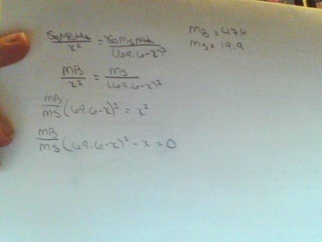

Yeah, I was just getting some pretty ridiculous numbers. I'm trying again now to see if I get a better answer.
(I'm reattaching the photo that should have been attached up above so you can see where I'm coming from, hah)

Aha! That's where you're coming from! :)
Third attempt, again incorrect.
Can anyone point out where I'm going wrong?

Well, this is the way to go!
Why would you say the numbers are ridiculous?
They look about right, although you appear to have switched the masses around, giving you an answer that is too close to the wrong mass.
