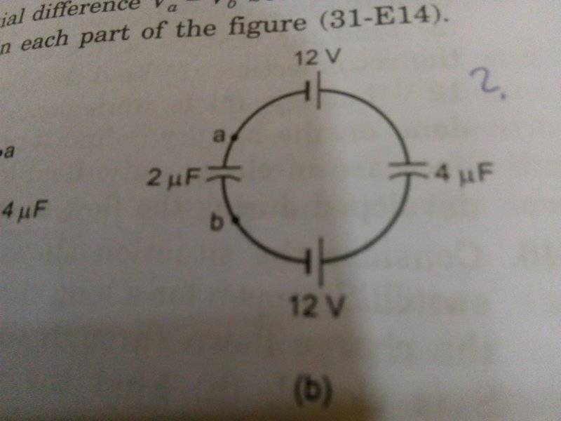

Assuming that neither the batteries or the capacitors have ohmic resistance:
The capacitors are not exactly in series, however what can u say about the (transient) currents ##I_1## through the left capacitor and the current ##I_2## through the right capacitor? Are they equal? Why? And if they are equal what can you infer for the charges ##Q_1## and ##Q_2## of each capacitor?

Apply KVL which is potential difference in any close loop is zerocarlyn medona said:Homework Statement
Find potential difference between a and b in the figure
Q=cv
can anybody tell me how to apply the equation in this problem with more than one cell[/B]

So will potential difference between the two capacitors be equal and opposite, and I thought charge through them will be same, not sure, I am not good with multi cell circuits

charges will be the same but voltages not necessarily. Apply KVL in the circuit knowing that the voltages at capacitors are ##\frac{Q}{C_1}## and ##\frac{Q}{C_2}##.
carlyn medona
I applied loop rule and got v1+v2=0
Am I doing something wrong

Yes you are not applying loop rule properly

Are v1, v2 the voltages of capacitors or of the batteries?
carlyn medona
Capacitors

Ok then you are correct. Now replace V1 , V2 with what I said at post 5 and find Q.
carlyn medona
But q is same and c is different and v1 +v2 =0 so is q equal to zero, so no charge pass through capacitor and have v1= v2=0
