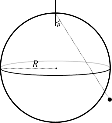

Given a spherical shell of radius R and the surface charge density
being the angle from the top of the sphere
and
being a constant) find the electric potential
and the electric field
inside and outside the sphere. Check that both the potential is continuous inside and outside the sphere and that
inside and out. I made this little diagram to illustrate.
2. Homework Equations
I can't even understand this problem. I feel like the point of interest shown in the diagram should be on the shell so that
can return a meaningful value, but I need to find the potential and electric field everywhere, so it can't be on the sphere.
Hello Guff,
I notice that your problem statement mentions a charge distribution on the surface of the sphere, but that there is no equation where charge or charge density plays a role. Is there something you can add to your 'toolbox' ?
BvU said:
Hello Guff,
If I looked at the charge distribution a point charge the field would look like this
%5Cfrac%7B%28%5Csigma_%7B0%7Dcos%5Ctheta%29%284%5Cpi%20R%5E%7B2%7D%29%7D%7Br%5E2%7D%5Chat%7Br%7D.gif
, but I know that isn't correct because I believe the total charge is zero. because half of the values of
are negative and the other half are positive.
I still don't see how you want to find the field or the potential at a point in space.
Where exactly on the sphere is ##\cos\theta## negative ?
