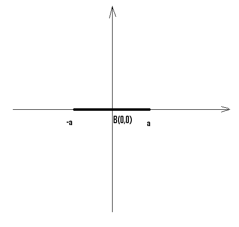

Find the potential of the point in the origin in regard to referring point at infinity if there's charged line laying on x-axis as shown in the picture.
I know two ways to find a potential:
V=∫dV and V=∫E*dl
using first formula i have dv=dQ/4πε0r and i have Q=Q'dl but i don't know how to integrate that, i mean i have dl and i don't know what to do next.
Integrate along the line from -a to a?

When i integrate from -a to a i get V=∫dQ/4πε0r=Q'/4πε0∫dl since ∫dl=2a i get V=Q'2a/4πε0r but this seems way to easy, so I am not sure is it correct.
I don't know what you mean, i have to find the potential at point B(0,0) and referring point is at infinity. That is how it's defined.
Setting up the integral is easy.

Yes, but you cannot do this if the integral diverges.

what is r?
I don't know what you mean, i have to find the potential at point B(0,0) and referring point is at infinity. That is how it's defined.[/QUOTE]
what mfb means is the potential at the origin is infinity. You have been given an impossible assignment!
