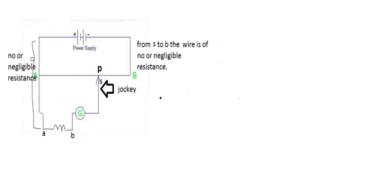

Circuit schematic of a potentiometer: a power supply cell feeds a uniform wire AB, a jockey at point p touches the wire, and a galvanometer G connects p to terminal b, with terminal a joined to A.
a is at same potential as A(as connecting wire is of negligible resistance.And p is particular point is found to be at same potential as b because galvanometer shows zero deflection.My question is why p is a particular point to be at same potential as b,i mean if from s to b the connecting wire is of negligible resistance than any point between length AB will have same potential as b.I think it is because galvanometer internal resistance.So that means galvanometer resistance is same as resistance present in length Ap.Am i right?

The photo is welcome.
AB is a resistance wire; it has resistance all along its length. By sliding the jockey along it, you can set point P to have any potential between the battery's (+) potential and ground. (It might help if you showed the wire AB of a different thickness or color, so as to clearly distinguish it from hookup wire.)
☞ What is that element between points a and b?
☞ What is that element between points a and b?[/QUOTE]
It is resistance.
It is resistance.
I think you should be considering there is a voltage source between points a and b, not a resistance. The potentiometer allows you to determine what voltage that voltage source is. That is the purpose of a potentiometer. The galvanometer indicates when the voltage at the sliding jockey equals the voltage of the unknown voltage source Vab.
If the unknown voltage source has resistance, too, that doesn't matter, because when the galvanometer indicates a balance point, there is zero current from/to that voltage source, so there is no potential drop across any internal resistance.
It's not surprising you were confused, when you thought it was just a resistance. ?:)

NascentOxygen said:
It's not surprising you were confused, when you thought it was a resistance. ?:)
It was drawn a resistance there but it was said that the potential difference across that resistance is measured. That resistance was part of a circuit, containing voltage source. A very confusing video !
Ah, so the seed of confusion was set in the video.
All sorted now, I hope.
Have you also assumed resistance free or of negligible resistance conducting wire?
That is always a default assumption, in any circuit. But based on what I wrote, you yourself should now be able to highlight those connecting wires where extra resistance will make no difference to the result. What is the key factor to identifying those wires?

A and a ,p (if zero deflection point is shown by galvanometer at point p)and b.But i am not getting one thing if two points have resistance between them then how can they be at equal potential as presence of resistance results in potential drop.
At balance, how much current is flowing through the galvanometer and its connecting wires?
Perhaps you are still not appreciating that between a and b there is a battery of some to-be-determined potential? So when the potentiometer slider is moved to the exact same potential as that of the battery, those voltages will be equal.

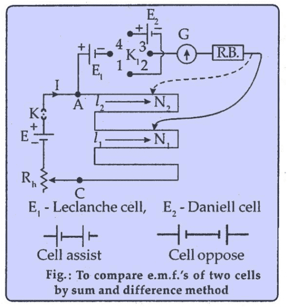

Bystander said:
short circuits
So,gaps 2 and 3 are really closed? It is a path traveled by current where no electrical impedance is encountered.But what it has to do with sum and difference method?
No. If gaps 2 & 3 are closed, it short circuits E2, which would make it equal zero potential before the cell burned up or exploded.
