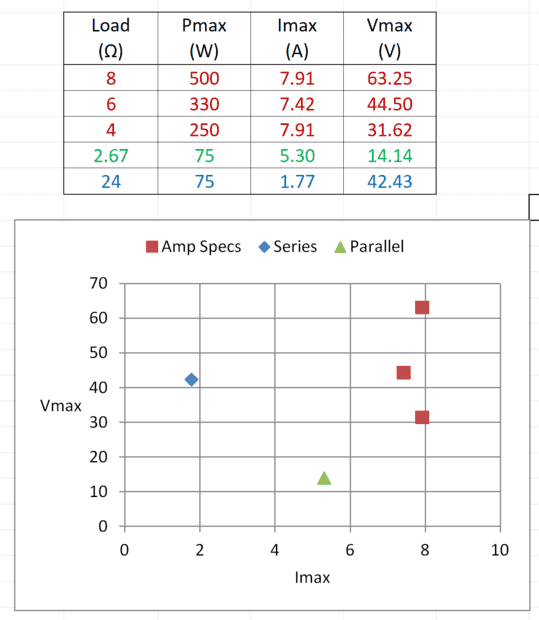

Hello. I have a question regarding an power amplifier (signal generator). I have three exciters and want to connect them to the power amplifier. One exciter have a impedance of 8ohm and power of 25 watt. The ampliefier have one output with the electical data: 4 ohm : 500watt; 6ohm: 330 watt and 8ohm : 250 watt. now my question. It is possible to connect all three exciters over the one output from the apmpliefier? If yes, why?

Those are the max or ideal ratings telling you how much power they can supply. At 8 ohms, 250 watts your amplifier should be able to put out ~5 amps. So, your three exciters at 8 ohms 25 watts would require 1.6 amps each in parallel or 1.7 amps in series. If I did the math correctly, you should be fine.

##250=I^2 * 8##
##I=5.5##
That would be the current for the amplifier.
##25=I^2 * 8##
##I=1.6##
That would be the current to each "exciter" in parallel.

If they are all the same, then yes I think it should work with the loads in parallel. Then your equivalent load would be 2.7Ω, with 75W, 5.3A, 14V at the limit. I think series may not work because of the higher voltage required (42V max). Amplifier stability will probably be OK. The specs imply at least a 4Ω - 8Ω range, 2.7Ω isn't too far away from that. If you're an audiophile, you may want more damping, IDK.
Edit: Series should also work.

Sure the amp can handle the exciters. Can the exciters handle the amp?
It seems the amplifier can produce 125 V Rms to put 500 W into a 4 ohm speaker. you would blow up an 8 ohm 25 W exciter at more than 10% of the maximum signal. Even with 3 exicters in series you get about 28W per exciter.
