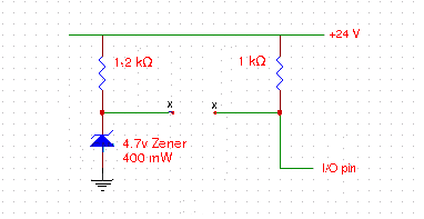

In a robotics project and need an indicator to show the operator when the safety circuit is open or closed. Got it done in software but need a physical idiot light. Thinking a bright red/green bi-color led. Have 24 vdc constant supply and a pin that sinks to ground (100mA max) just while the door is closed. Can only use the channel on the I/O connector (the pin) as the signal for the open/closed condition. No additional switches or contacts and KISS would be greatly appreciated.

Yes, that's a simple and direct led circuit. I was trying to get fancy and have a single circuit be green while pulled down by the I/O and red while "open". Remembered just enough to get lost in a reversed bias transistor circuit.

In principle it can be done using 3 resistors, but is wasteful of current. Instead, the arrangement below is almost as simple and is more economical with current. A 2 pin bi-colour red-green LED connected between the X-X points will have 18mA in one direction or the other. The 4.7 volt zener diode can be a low power zener, 400 mW will do, otherwise 1 W.
The assumption I used is that your I/O pin can sink current (approx 45mA in this case), but does not source current (i.e., on HIGH it's an open circuit).
Bear in mind the caution given by Berkeman regarding a composite R-G indicator being inherently unsafe. (pun intended). :wink:
