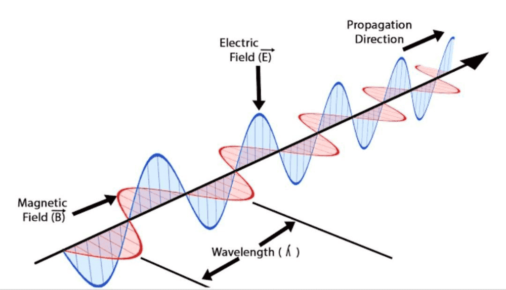

My question: do the electric and magnetic fields both have 0 phase difference? So that at any time either both are maximum or both are minimum?
Yes, that's correct! E and B are completely in phase with each other. It's a bit complicated to prove that, but the idea is that when you apply Maxwell's Equations in free space (no charges or no currents), the only two non-trivial equations you end up with will be Faraday's Law and the Ampere-Maxwell Law. You can apply both of these on a closed loop in the EM wave, and you will end up with the following two equations:

This implies that both E and B are completely in phase with each other, traveling in space with speed c.
https://brainly.in/question/14841109
A simple diagram of an EM wave also indicates that you are correct, they peak at the exact same times (in phase with each other). An understanding of this can follow from just looking at Faraday's Law and the Ampere-Maxwell Law in the case where there are no charges and currents. What will a changing magnetic flux cause? An electric field. What will the flux of that electric field cause? A magnetic field. And the process continues to cycle through, everything completely in phase with each other (as you correctly mentioned).

That was very clearly explained.
Thank you very much!
