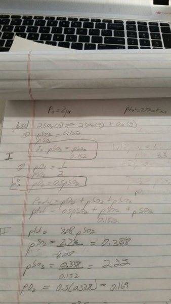

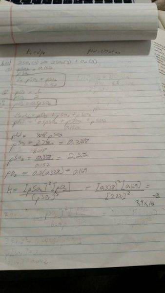

Moose100
- 116
- 0
Ptotal=pO2+pSO3+pSO2
pSO2/pSO3=0.152
pO2/pSO2= 0.5
Ptotal= 0.5pSO2 +pSO2/0.152 + pSO2
Ptotal=8.08pSO2
pSO2=2.73/8.08=0.0338
pSO3=0.338/0.152=2.22
pO2= 0.169
k=[pSO2]2[pO2]/[pSO3]2
k=[0.338]2[0.169]/[2.22]2
k=3.9 × 10-3
pSO2/pSO3=0.152
pO2/pSO2= 0.5
Ptotal=8.08pSO2
pO2= 0.169
k=3.9 × 10-3

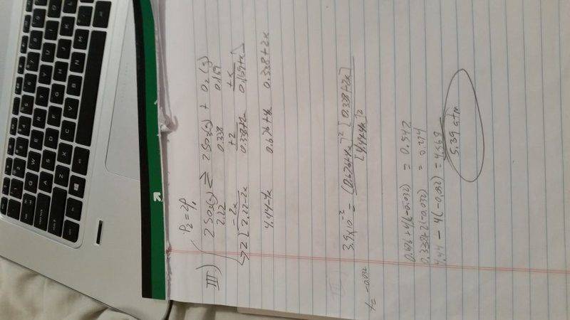

Moose100
- 116
- 0
1. If they are correct the equilibrium values become the initial values upon the change in condition. I.e. Moving the piston in halfway.
2. V2=V1/2
P1V1=P2V2
P1V1=V1P2/2
2P1=P2
3. 2SO3 2.22-2x
2SO3 0.338+x
O2 0.169-x
Ok this is where I spent many hours last night. One because I seem to be stuck at factoring the 2P1 concept and also I am still shaky if these are the right pressures. When using the equilibrium constant to solve for the new pressures.
k=[pSO2]2[pO2]/[pSO3]23.9 ×10-3=[pSO2]2[pO2]/[pSO3]2
2. V2=V1/2
P1V1=P2V2
P1V1=V1P2/2
2P1=P2
3. 2SO3 2.22-2x
2SO3 0.338+x
O2 0.169-x

First check results for consistency.
You say pO2/pSO2= 0.5 but it isn't in your conclusions. - only a decimal point mistake or other?
Then I would like to say that - I don't know that this is always followed, but In my book equilibrium constants have to have units.
Well for reactions like A ⇔ B, or A + B ⇔ C + D the eq, constant is dimensionless, but in your case it has the dimensions of pressure and units of atm. Somebody else might use torr etc. but it could also have been concentrations and M (as I was assuming in my sketch). You could have done the whole thing in terms of concnetrations but I think it is equivalent reasoning and only units and their numbers different - hope this will be clear to you.
If and when this is right, I have not checked everything, you have done the first two steps of #14.
The next will be step 3. I think the equation is not as horrible as I first thought, but you can begin formulating that.

Ahh I see what you mean the ratio is inflated by 10.
Moose100
- 116
- 0
Oops got my notes out it was a typo.
Moose100
- 116
- 0
epenguin said:First check results for consistency.
The K I got is then 3.9 × 10-3atm
Moose100
- 116
- 0
[0.338+2x]2[0.169+x]/[2.22-2x]2=3.9×10-3atm
At equilibrium under the new conditions P2=2P1
That means we multiply these equilibrium expressions in the brackets by two:
(0.676+4x)2(0.338+2x)2/(4.44-4x)2=3.9*10-3
Eventually, we get x= -0.032atm
so
0.676+ 4(-0.032)=0.548atm
0.338+ 2(-0.032)=0.274 atm
4.44 + 4(-0.032)= 4.568 atm
= 5.39 atm
so
= 5.39 atm

- 3,638
- 1,014
I don't usually check peoples' arithmetic but often notice anomalies like that.
I'll assume no more mistakes. Actually figures sound to me reasonable.
Parts 1 and 2 of the problem are things I'd say should be expected of you with your background - fairly elementary physical chemistry calculations. Part 3 is more challenging. Before we get into that - and it is too late night for me to concentrate - I think equally to be expected of you is you can translate those pressures (including the eq constant) into molarities. Especially if you are preparing for an exam, plus two other reasons.
I at least find it not simple to imagine what happens to pressures when you halve the volume. It is easy to imagine what happens to total concentration of something in all its forms. If the substances were not reacting your PV laws would hold, but if they react? Also I think your work here suffered from lack of explicitness. If you had written out things like the equilibrium equation you would have saved time and mistakes in the immediate, and also in the long run as when you revise you (as well as us) may not understand why you wrote something. It would be good to write out a couple of equations connecting molarities e.g. of [O2] (= x) and the other things.
