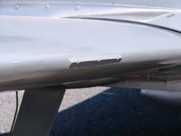

DarioC said:
Added: Are you familiar with the triangular strips of metal that are put on the leading edge of the wings, near the fuselage to make that part of the wing stall before the outboard part where the ailerons are?
Rather interesting little detail on real-world wings.
That's not what those triangles do. Those are vortex generators and they actually delay stall. The turbulence they induce energizes the boundary layer near the wall and makes it more resistant to separation.

  • #72
On the triangles, I think somehow you have misunderstood which "triangles" I meant. The ones I am talking about are very small long strips that are located on the leading edge of the inboard part of the wing. Their purpose is to disturb the airflow at high angles of attack and cause the inboard part of the wing to "stall" before the sections outboard that have the ailerons. The desired result is the you dump a lot of the lift of the wing before you loose roll control when the aileron area stalls. It allows you to get a good comfortable sink rate during the final flare. A Beachcraft Bonanza has them as I remember and some others I am sure. I suspect they are called something like leading edge spoilers.
They are completely different in appearance and function from the various vortex generator "tabs."
Of course air goes under the wing as well as over it, but I was talking about the air going over the wing specifically, I wasn't discussing the air going under the wing, that is why I didn't write anything about that part of the airflow.
Anyone who has compared the landing characteristics of a Piper cub versus a Taylorcraft will understand the significance of the shape of the wing leading edge. Interestingly enough those two planes were designed by the same person.
Stall strips... eh ? . :oldsmile:
  • #74
Yes that is one. Thanks for the photo.

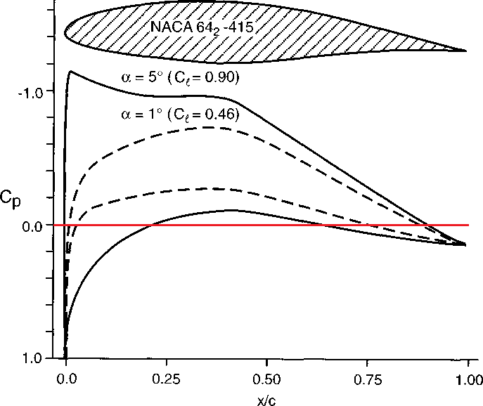

  • #76
fog37 said:
The pressure on top of the wing is slightly lower than the free stream pressure. This pressure distribution produces a net force Ltop on top of the wing directed downward.
Wouldn't the total force acting on the upper surface of the wing be pointing upward?
fog37 said:
The pressure at the bottom of the wing is slightly larger than the free stream pressure farther away from the wing and produces a net lift force Lbottom.
The actual pressure distribution depends on the airfoil and angle of attack, but typically, while the pressure acting on the lower surface near the trailing edge may be above free stream, the rest of the bottom surface experiences pressures less than free stream. So the total force (on the lower surface) would be directed downward, but smaller than force acting on the upper surface.
(The variable L usually stands for lift, so it's better to represent total force by F, or Fupper, and Flower).
  • #77
There is almost nothing about that analysis that makes sense to me. At the most fundamental level, a fluid cannot exert a pressure force on a surface in any direction other than normal to it and toward it. Any force on the upper surface points down, and any force on the lower surface points up.
  • #78
That goes against all the mechanics I ever learned. A gas can't 'suck'. The lift has to be because of the fact that there is more total (positive) pressure upwards than (positive) pressure downward.
  • #79
The pressure above the surface is lower than the free stream atmospheric pressure. The pressure below the wing is higher than the free stream atmospheric pressure. A pressure gradient is directed from high pressure to low pressure which I assume that is where the net force point. would point.
We know lift is due to the pressure difference between the top and bottom surface. But, given the relative difference between free stream pressure and the pressures at the wing produce a net force point down on both the top and bottom surfaces?
  • #80
Again, it is literally impossible for a fluid to "pull" on a surface. The force is always directed normal to and into the surface. Always.
  • #81
Ok, I finally get it. What matters is the local pressure distribution on the top and bottom surfaces of the wing to produce the net lift force.
A gradient is a vector pointing from small to large values. I guess I got confused about these negative of the pressure gradients, ##- \nabla p##, one directed towards from the top surface and one directed away from the bottom surface.
  • #82

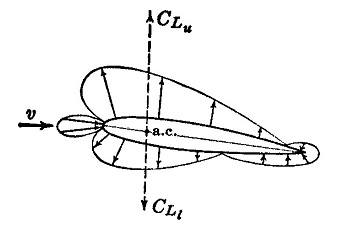

Diagram of lift coefficient distribution from Airplane Performance Stability and Control -- Perkins and Hage.

  • #85
FactChecker said:
The pressure gradient is derived from the difference in pressure.
The difference between which pressures?
FactChecker said:
The pressure force is always normal to the surface and directed from the gas toward the surface.
There is pressure (force/area), and then there is force. Which one are you analyzing? If it's force, then aerodynamic force has both normal and tangential components. The tangential component (skin friction) arises due to viscosity within the boundary layer.
  • #86
Between the pressures at two infinitely close points. It's a derivative of the pressure.
Sorry. I should have said the force due to the pressure.
Good point. I was ignoring any tangential force for discussion of lift. Actually, this is not my area of expertise and I am not sure exactly how the viscosity relates to pressure in this situation.
