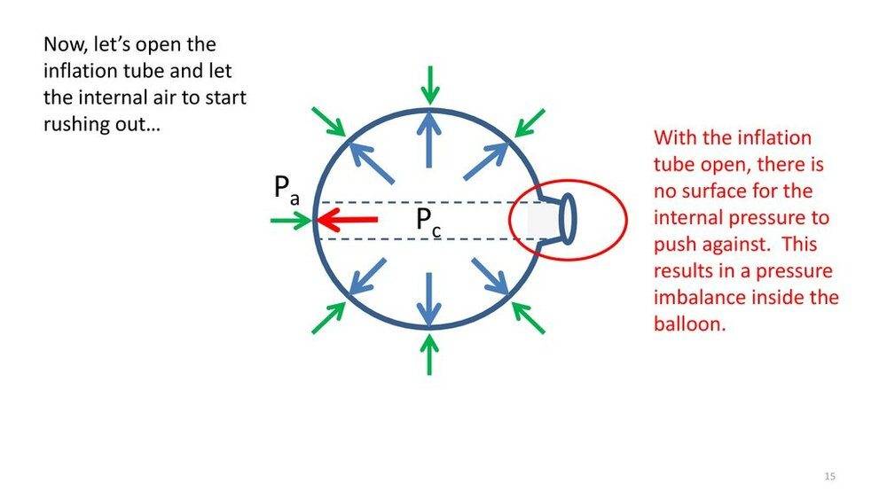

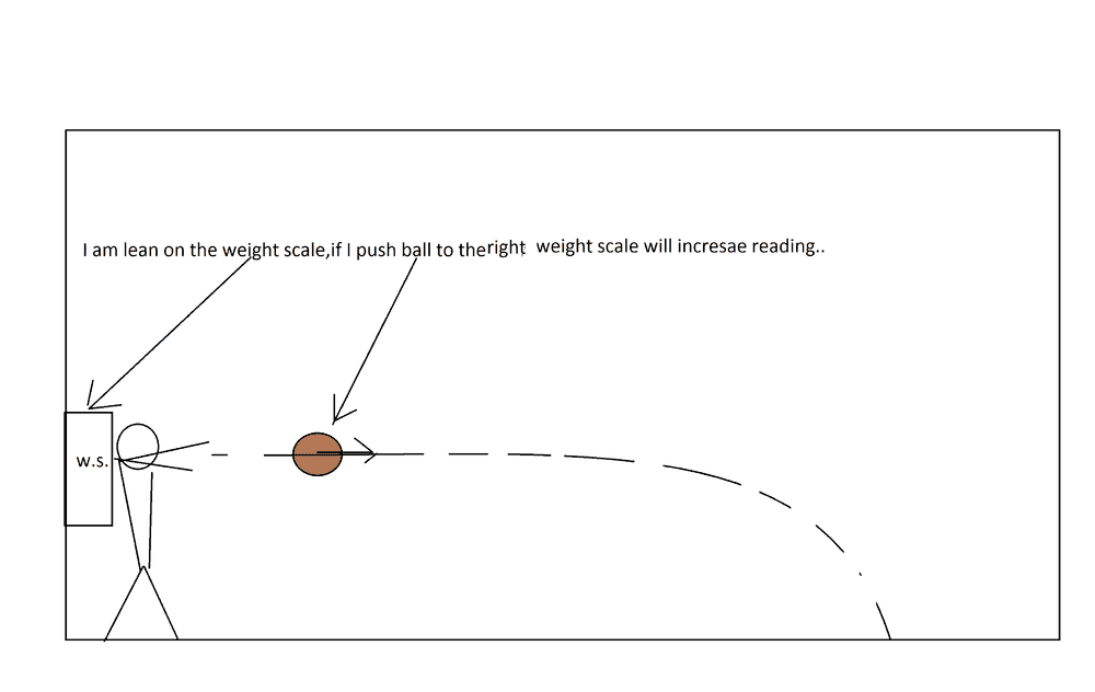

Fluid can exert force to object(move object) only through pressure and tangential stress caused by viscosity.
if we look at balloon rocket ,here is Newton 3 law action-reaction,but this 3 law as usual don't tell nothing how fluid really exert force to the ballon..
it exert through pressure imbalance,because on open end there is no internal pressure to push against,so thrust = (Pc-Pa) x A(area of open end)
just like sail /wing pressure differentila x area = force(lift)
But if we have balloon with water at 5bars and balloon with air at 5bars,same nozzles,ballon with water will have far more bigger thrust..
How we can explain why balloon with water will has bigger thrust IN SENSE OF PRESSURE DFFERENTIAL?(i know that thrust formula inculde mass flow rate(so water due to higher density has bigger mass flow rate,so that make difference in thurst magnitude),but i want explanation through pressure differetnial because that is really and only physical way how fluid can move object...)
So if both balloon are at 5 bars where is that bigger pressure differential(imbalance) in water case??

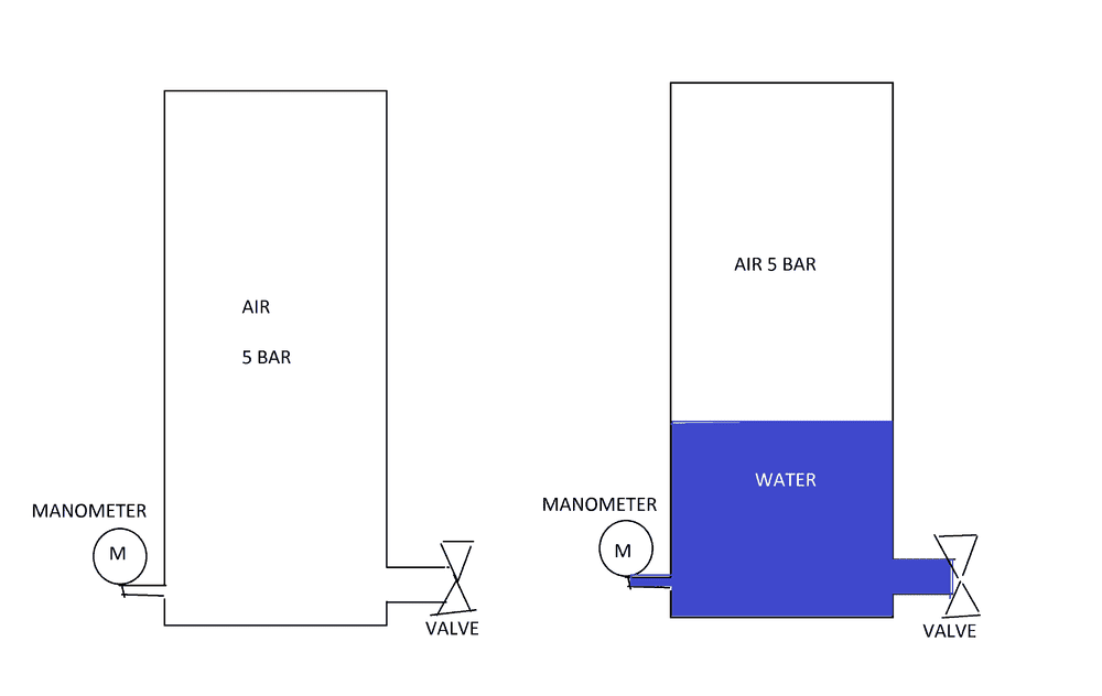

so...
when valve is closed both manometer will show 5 bars(if you don't take to account water height-additional hydrostatic pressure compare to air..)
when vlave is open will manomenter at right tank(with water) show greater pressure than left(with air),so this will "justifay" in sense of pressure differential why tank with water will have greater thrust??(if you put this tanks on skateboard,tank with water will accelerate faster than with air)
so will right manometer in same manner show higher pressure,when water accelarate to the right when valve is open,compare to tank with air?
How sure are you that there is a thrust difference?
I'd expect the exhaust velocity from an air filled balloon to be significantly higher, and the balloon to empty faster (given identical internal pressure), so you'll have more factors than just the difference in density to cause a thrust difference.
In addition, your diagram will underestimate the thrust, since the fluid velocity near the nozzle will be nonzero, and thus the pressure on the balloon near the nozzle will actually be lower than the pressure on the balloon far from the nozzle. In addition to there being no internal pressure on the balloon where the hole itself exists, there will be a larger region around it with reduced pressure, causing greater thrust than you expect.
(Things are further complicated in your "5 bar" case by the fact that this will cause the air flow to choke in the nozzle, creating sonic flow, but we can solve that for now by just imagining a much smaller internal pressure such that the flow velocities remain small instead)
Aeronautic Freek said:
(tank with water will accelerate faster than with air)
Will it accelerate more initially, or will it accelerate over a longer period of time, and thus gain more momentum in total.

Yes, with the same pressure everywhere in the tank in both cases, and the same straight nozzle, the thrust will be the same.
I don't necessarily agree, because as I said, the pressure adjacent to the nozzle won't necessarily be the same.
So which one will have greater thrust?
does theory said that thrust will be equal?
The thrust at equal tank pressure will be the same (assuming the idealized setup in post #1, which is good enough here). However, the there is no reason to assume that the tank pressure over time will be the same. The idealized setup doesn’t let you calculate an accurate time/pressure curve (for that you need a realistic setup in which fluid dynamics effects determine the flow of propellant) but you can get something qualitatively reasonable by assuming that the propellant is only subject to net force while it is in the short stem nozzle and accelerates according to ##F=ma## while there.

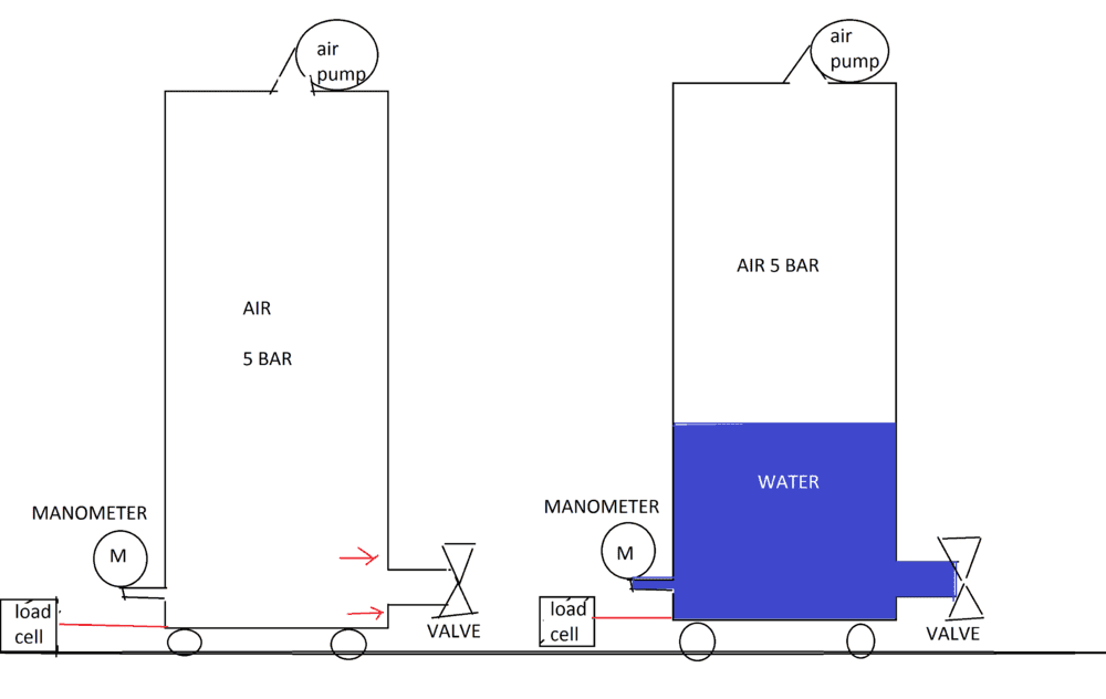

lets set my question ,with constant pressure in the tank,it is easier to solve problem...and to stope confusing mebers with my initial setup
so
-so we have pumps which pump air in the tank and hold constant pressure (5bar) even when valve is open, in both cases
-nozzle is the same
-tank is put on wheels and connect to load-cell which meassure thrust force
two questions;
1)which tank will show higher thrust,when we open valve at nozzle,with water or with air inside?
2)will both manometers show 5 bar,when we open valves?(neglect hydrostatic pressure caused by water column)

As @cjl writes, it depends on how accurately you want to be the same, because there might be minor effects that are difficult to predict.
But on your general question: Yes, the thrust is completely accounted for, by the integral of the pressure forces acting all around the tank, regardless if the pressure comes from air or water. The uncertainty here comes from your hypothetical setup, where it's not clear if you can realize the same pressure everywhere in the tank in a dynamic flow situation.
