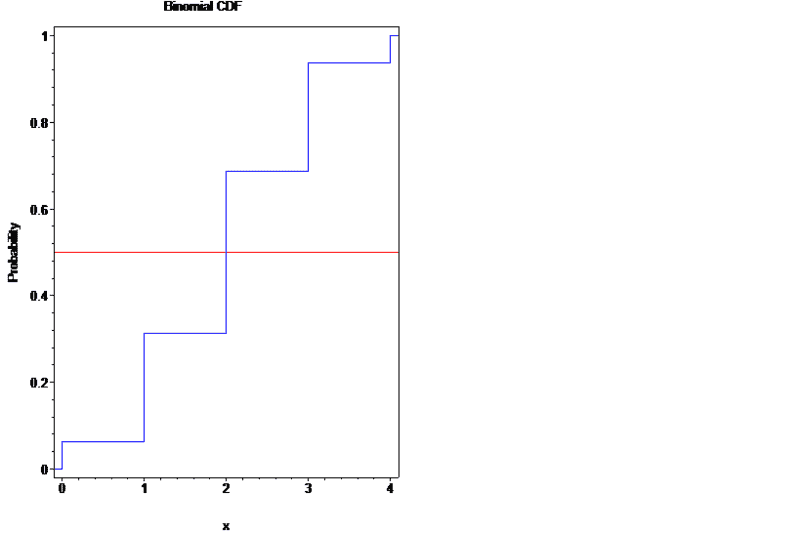

Attached is a plot of the cumulative distribution function, together with the line at probability = 0.5. The median is the point at which the two graphs cross.
Thanks Ray, is there another method that you can use apart from the graph. Thanks for your input.

Yes. The median is either at the 50th percentile (if there is one), or else is the point at which the CDF jumps from a value < 0.5 to a value > 0.5 as we go through that point. For example, in the above we have the cdf ##F(x)##:
$$\begin{array}{cc}
x & F(x) \\
\hline
0 & 0.0625 \\
1 & 0.3125 \\
2 & 0.6875 \\
3 & 0.9375 \\
4 & 1
\end{array}$$
The function ##F(x)## jumps up from below 0.5 to above 0.5 as ##x## passes through ##2##, so ##x = 2## is the median.
