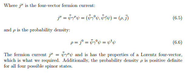

The probability density of the dirac spinor is known to be ∑(Ψ)2 and I know how it is derived. However, I'm just wondering why it should be positive definite. Since the lower two components represent antiparticles, so shouldn't the probability density contribution of those two components be negative? Or actually what does that probability density represent? Thanks!

Hi vanhees, thanks for the reply but sorry I think I don't really get your point. What I mean is essentially this:
I see quite a few textbooks interpret this as the probability density, and I didn't really thought about the lagrangian.
In which textbook have you found this? It's highly misleading at best!
There is no proper interpretation of a 1st-quantization approach to relativistic QT or only in the non-relativistic limit. The reason is that at relativistic energies you have always the possibility of creating and destroying particles, and that's why relativistic QT is formulated as QFT, which is the most convenient way to describe situations, where the particle number is not conserved, and in my opinion that's the way relativistic QT should be introduced in the 21st century!

I believe that both @Josh1079 and @gerald V's confusion comes from textbooks which are treating the "Dirac equation" as an equation for a single-particle wave function. This is often done without cautioning issues which this approximation makes. In particular, particle number is not conserved, so a "one-particle" treatment is clearly not possible. Indeed, even if you only deal with energies much less than mc^2, and even if you start with a positive-energy single-particle state, if you time-evolve a solution to the Dirac equation long enough you'll get admixtures of states with negative energy, and probability won't stay conserved.
