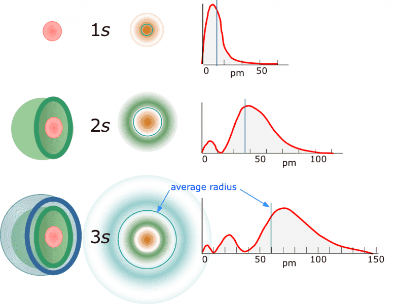

Since an atom is a 3d object, there are several ways to get peaks in the probability density function. You will have seen that n is the number of radial peaks.
I was referring to this point on the site:
"Each wave pattern is identified by an integer number n, which in the case of the atom is known as the principal quantum number. The value of n tells how many peaks of amplitude (antinodes) exist in that particular standing wave pattern; the more peaks there are, the higher the energy of the state."

Can you explain it in easy words? Aren't the peaks representing the frequency and energy of the probability wave?

What is the radius for the n=1 peak?
What is the Bohr model radius for n=1?
Do these agree?
I realized now, from the Ist image the average radius of n= 3 agrees with Bohr's radius of n=1 that's 53 pm I think. But I don't understand why?
And what does these peaks represent?
Also when we say electron in 2s has lower energy than 2p, because of screening effect,I couldn't understand what is meant by p orbital being higher than s? They've same n, so same energy but the energy lowers because of the screening effect?
The peaks represent the maxima of the probability density function.
