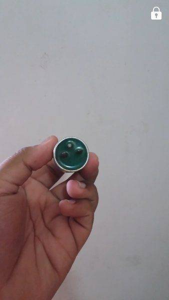

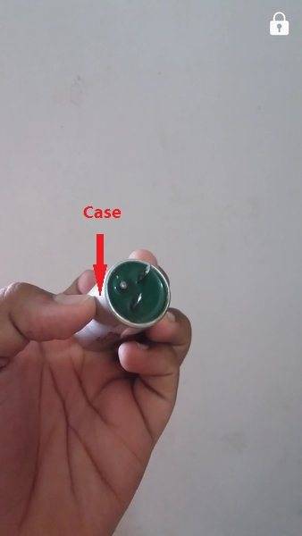

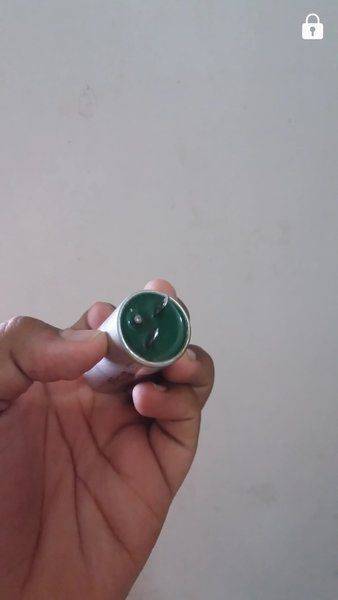

I have a capacitor from a fan. The electrician says it's dead, but I think he is lying. I want to test it with a multimeter. But I can't identify which terminal is positive or negative as it's old and from local company.
A poor video of the capacitor is below:
A few pics from the video:

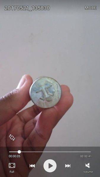

A sign on the bottom: company logo or identifier?
I came to kmow from a site that a fan capacitor used for starting the motor is unpolarised. Is that correct? If so, then I don't have to think of positive or negative terminals while testing, right?
If not, please help in identification.
Note the sign it has at its bottom: is that a company logo or an identifier?

That appears to be a metalized polypropylene capacitor. They do not have a polarity as far as capacitor operation is concerned. They will often be marked as to which terminal is connected to the outer metal layer.
Also motor capacitors must be non-polarized in general.

So, when I test it with a multimeter, i don't have to look out for polarity, right? So the multimeter probes can be used on either terminal?
Yes. Also check for short to the case from both terminals.

Check for short circuit to the case. Both terminals should have a very large resistance to the case. Your meter will likely read open if everything is good.

Just to be clear. Here's the case.

Yes, that I understood, but the "read open" part is unclear, rest is fine.
