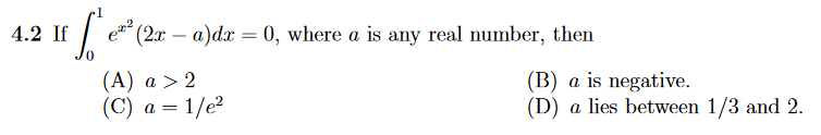

Refer the image.
Integral (e^x)dx from 0 to 1=e-1.
Refer the other image. The graph of e^(x^2) increases more slowly than e^x till x=1.
So 'a' is clearly greater than 1. Is this right?
What does ##e^x## have to do with anything? The integrand is ##e^{x^2}##.
