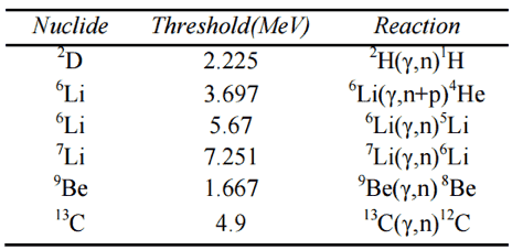

artis said:
I do think that for BNCT they use Beryllium as the target due to Beryllium being more chemically stable and safer to work with than Lithium, which among other things burns in contact with water a far as I'm aware.
9Be is used as a target for gamma rays that induce a photon,neutron reaction, since the energy threshold is about the lowest. Be is highly toxic to life forms, so has to used with care. The photoneutron threshold for 6Li and 7Li is considerably greater.
