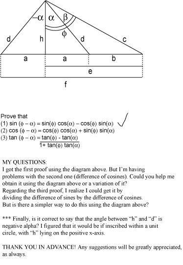

Hi,
I am working on proofs of the difference identities for sine, cosine, and tangent.
I am hoping to solve these using a specific diagram (attached).
I was wondering if you could help me with the difference of cosines. Is it possible to derive it using the attached diagram? If so, how could I go about this?
Details and a relevant diagram are attached.
Thanks
Hey PatternSeeker.
If you know the difference between the sines, you can use the fact that sin(x) = cos(pi/2 - x) and then get the identities for difference or sum or cosine terms instead of sine terms.
With the tangent, will need to expand and simplify out sin(a+b)/cos(a+b).
