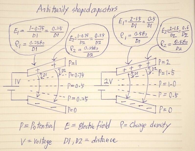

For capacitors of arbitrary shape, when the applied voltage is doubled, the charge density at any position on the conductor surface doubles, as shown in the figure below.
Note that ##~E_1~##and##~E_2~## are the electric field strengths at the conductor surface, their vector directions are perpendicular to the conductor surface. Also, of course, an accurate potential distribution can only be obtained by solving the Laplace′ s equation ##~\nabla^2V=0~##(source-free region). You can first solve the Laplace equation, then calculate the electric field on the conductor surface based on the potential distribution, and then calculate the charge density on the conductor surface based on this electric field. :smile:
Therefore, when the voltage applied to the capacitor changes, the surface charge density at any point of the conductor and the total charge of the entire conductor change in the same proportion.
Surface Charge ##~~~~~~~\rho(x,y,z)~\to~c\cdot\rho(x,y,z) ##
Total Charge ##~~~~~~~ \iint \rho(x,y,z) dS~\to~c\iint \rho(x,y,z) dS##
If you are still unconvinced or in doubt, maybe you need to study the properties of the solution of Laplace′s equation under certain boundary conditions, including uniqueness, linearity, etc. But I'm actually very bad at complex and esoteric math myself. :bear:
How did you get ##\rho=E\epsilon_0##? Is this supposed to be the differential form of Gauss' law? You'd get infinity for the ##\nabla\cdot\vec{E}## due to the surface charge.
This follows from Gauss's law at the surface of any continuous conductor. As one gets close enough to the surface it is locally flat and you make the usual Gaussian pillbox. A useful result.
jkfjbw said:
How did you get ρ=Eϵ0? Is this supposed to be the differential form of Gauss' law? You'd get infinity for the ∇⋅E→ due to the surface charge.
Drawings are sometimes difficult to express in detail and can therefore be exaggerated and crude.
Of course, you need to calculate the electric field with the potential change very close to the conductor surface, and then calculate the conductor's surface charge density with the electric field very close to the conductor surface
This requires an analytical solution of the Laplace equation, or the use of a computer to obtain a very detailed and accurate numerical solution.
