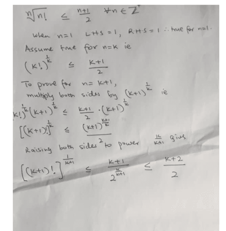

i see that the inequality is not correct, i want to take my time today to analyse the remaining bit of my working and also to look at his working, step by step...lets talk in the course of the day...
  • #32
my friend managed to re check his working on the problem and i can follow through his steps with ease kindly see attached below;
  • #33
  • #34
now let me continue with where i left...give me some moment...
  • #35
He still needs to justify that last step.
  • #36
PeroK said:
Yes, but you should prove that last inequality using a separate induction. To help you note that:
$$2(k+1)^{k+1} = 2(\frac{k+1}{k+2})^{k+1} (k+2)^{k+1}$$
If you can show that:
$$\forall k: \ \ 2(\frac{k+1}{k+2})^{k+1} \le 1$$
Then you are done.

##2(k+1)^{k+1}≤ (k+2)^{k+1}##...ends up to your working

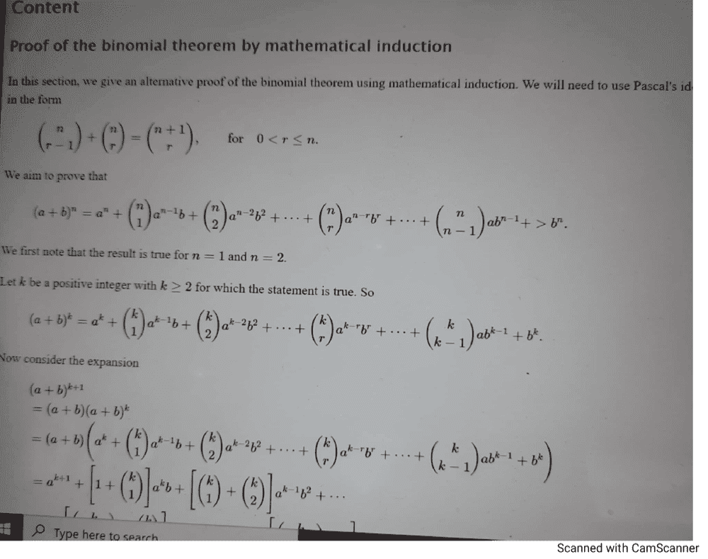

i know that we now have ##2≤ \frac {k+2}{k+1})^{k+1}≤ (1+ \frac{1}{k+1})^{k+1}##
  • #43
chwala said:
perok i need your guidance ...i understand the steps, let me know exactly what i am supposed to do and from which step of my inequality.
You need to prove that:
$$\forall k \ge 1: \ 2 \le (1 + \frac 1 {k+1})^{k+1}$$
And the hint was to use the binomial theorem. It might help to let ##m = k+1##, then we need to show that:
$$\forall m \ge 2: \ 2 \le (1 + \frac 1 m)^m$$
Can you see how to apply the binomial theorem?

No. To be honest, all I'm doing here is giving you the solution step by step. The binomial theorem applied here gives:
$$(1 + \frac 1 m )^m = 1 + m(\frac 1 m) + \binom m 2 (\frac 1 m)^2 + \dots + (\frac 1 m)^m = 2 + \binom m 2 (\frac 1 m)^2 + \dots + (\frac 1 m)^m > 2 \ \ (m \ge 2)$$
The result is that I've done the whole solution now.
