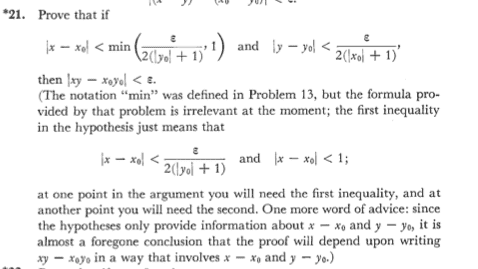

I am a little stuck here. I was thinking of using the fact that if a<b and c<d then a+c<b+d to write:
|x-x0| + |y-y0| < ε / (2|y0|+1) + ε / (2|x0|+1) and then use the constraint |x-x0|<1 after,
but I am not sure how fruitful that would be...I first have to get at the heart of his "hint" in that I must relate xy-x0y0 to |x-x0| & |y-y0| first...
Any thoughts?

Try subtracting and adding ##xy_0## in the expression ##|xy-x_0y_0|##.

What happens as ##x## gets as close to ##x_0## and ##y## to ##y_0## as the problem suggests? You have the triangle inequality to use...

I'm sorry LC, but where is this suggested? The problem statement only implies that ##-1 < x-x_0 < 1## and says nothing about ##y-y_0##.

Read the "IF" in the first line of inequalities in your copy of problem 21 that you posted.

Hi LC :smile: Again, I addressed this in the post above. All that is said is that ##-1 < x-x_0 <1 ##
Moreover, nothing is said about ##|y-y_0|##

Are we in some kind of time and space warp here? Read the first two lines of the problem 21 you copied. It gives you assumptions about both ##|x-x_0|## and ##|y-y_0|##.

Apparently we are. I actually logged out just to check that we are looking at the same image.
Line 1: ##|x-x_0| < \min\left(\frac{\epsilon}{2|y_0|+1},1\right) \Rightarrow |x-x_0| < 1 \qquad \wedge \qquad |x-x_0| < \frac{\epsilon}{2|y_0|+1}##
AND
##|y-y_0| < \frac{\epsilon}{2|x_0|+1}##.
You seem to saying that I can use the fact that "##x## is close to ##x_0##" to do something. I have not even gotten to what that something is yet because I am
reluctant to accept your assertion that "##x## is close to ##x_0##." Like I said, I am *reluctant* and need convincing. What is it that is written above that makes you think this? All we know is that x is within "1" or ##\frac{\epsilon}{2|y_0|+1}## of ##x_0##.

Have you used the triangle inequality on this yet? Remember what you are trying to do is make the left side < ε by overestimating it with something small. Do you see that getting ##|x-x_0|## and ##|y-y_0|## small will make it small if ##x## isn't too big? Can you keep the size of ##x## limited?

You are trying to get ##x## close enough to ##x_0## and ##y## close enough to ##y_0## to make ##|xy-x_0y_0|<\epsilon##.

It is less than the minimum of those and if ##\frac{\epsilon}{2|y_0|+1}## is a tiny number less than 1 it will certainly be close. And if ##\frac{\epsilon}{2|y_0|+1}> 1## it will still be less than ##\frac{\epsilon}{2|y_0|+1}## .

After you use the triangle inequality suggested above, what happens if you put those overestimates in for ##|x-x_0|## and ##|y-y_0|##?
Ok. So if I use the triangle inequality we have:
|x(y-y_0) + y_o(x-x_0)| \le |x(y-y_0)| + |y_o(x-x_0)|
which is bigger than the original expression. I don't know how that helps. Apparently I am too stupid for this subject.
You aren't too stupid. Just use what you know from the assumptions on that inequality that you just derived. The end goal is to chain together enough inequalities and get epsilon on the right side.

What did you start with that is equal to the left side that isn't in that equation? And you didn't answer the question in red above.

Hi LCKurtz :smile: I guess I might have been avoiding red question. I don't know what you mean "put in the overestimates." Do you mean to actually substitute ##|x-x_0|## with ##\frac{\epsilon}{2|y_0|+1}## ?
If so, I did not really know you could do that with inequalities. Is that what you meant though?
Here is what I have so far to summarize:
[tex] \begin{array}{c}<br /> |xy-x_0y_0| &=& |xy-x_0y_0 + xy_0 - xy_0| \qquad\qquad\qquad (1) \\<br /> &=& |x(y-y0) + y_0(x-x_0)| \qquad\qquad\qquad (2) \\ <br /> &<& |x(y-y0)| + |y_0(x-x_0)| \qquad\qquad\qquad (3) \\<br /> &<& \frac{|y_0|\epsilon(2|x_0|+1) + |x|\epsilon(2|y_0|+1)}{(2|y_0|+1)(2|x_0|+1)} \qquad(4)<br /> \end{array}[/tex]
Edit OK. I see that I kind "substitute" them in by transitivity. Just had to convince myself. I added it in as line (4). It would seem that if I could prove that the RHS of (4) is less than ##\epsilon## I could finish. So now I need to see if:
[tex]\frac{|y_0|\epsilon(2|x_0|+1) + |x|\epsilon(2|y_0|+1)}{(2|y_0|+1)(2|x_0|+1)} \stackrel{?}{<} \epsilon \qquad\qquad(5)[/tex]
Is this going in the right direction?

You are getting the idea. Yes, the idea is to get it less than ε. But before you go from (3) to (4) write$$
(3) \le |x||y-y_0| + |y_0||x-x_0|$$and then put in the overestimates and don't combine the fractions. Also, I didn't notice before but you have the parentheses in those denominators wrong. They are ##2(|x_0|+1)## and ##2(|y_0|+1)##. Once you do that see if you can see why each fraction is less than ##\epsilon/2##.
