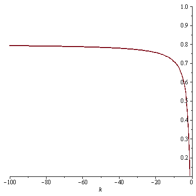

The integral gives [itex] P(0 < q < 3/k) = \int_0^{3/k} k(k+1) q (1-q)^{k-1} \, dq=\frac{12\cdot3^k k^{-k} (-1)^k(1-1/3k)^{k+1}+k-3}{k-3}[/itex] It converges towards 0.8 if I'm not mistaken
Line graph of a curve plotted against k from -100 to 0 on the horizontal axis and 0.1 to 1.0 on the vertical axis; the curve is nearly flat near 0.8 for large negative k, then drops steeply toward about 0.1 as k approaches 0.
What does this mean?

Why are you plotting it for negative values of ##k##? We need ##k = 1,2,3,4, \ldots##, so plotting it for ##k \geq 4## has meaning. Negative values of ##k## have no meaning at all in this problem.
Oh sorry, I'm getting tired, been stuck on this problem all day now.

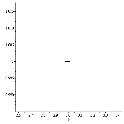

Plot of a horizontal line segment at y = 1 over k from about 2.98 to 3.02, with the axes spanning k from 2.6 to 3.4 and y from 0.99 to 1.015, and nothing else visible.
That's a strange plot. What does this mean then? :)
Is it something similar to a delta function, or have I made a mistake plotting it?

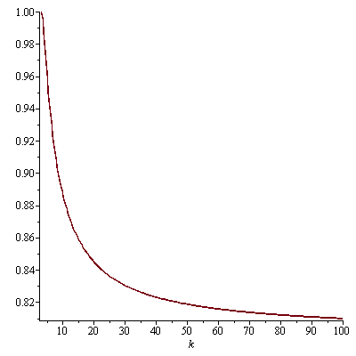

Part of your problem is that you have a result for your integral that seems to work for all ##k##, but when you specify that ##k## is a positive integer, it simplifies a lot; in particular, the pesky factors ##(-1)^k## disappear, giving you a formula that works well for all positive values of ##k \geq 3## (no division by 0 anymore). Then it plots out nicely.
Yea it looks better now:
Decreasing curve plotted against k from about 2 to 100, with y-axis from 0.82 to 1.00; it falls steeply at small k and levels off near 0.82 for large k.
But how do I continue from here?
So because q lies in C with the probability 1, C is a confidence interval? For [itex] k \geq 4[/itex] the probability is not 1 for large k. Is that a problem?

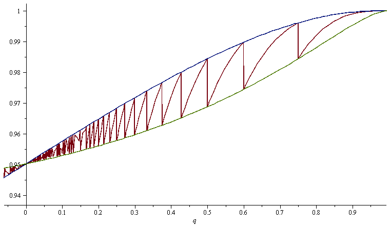

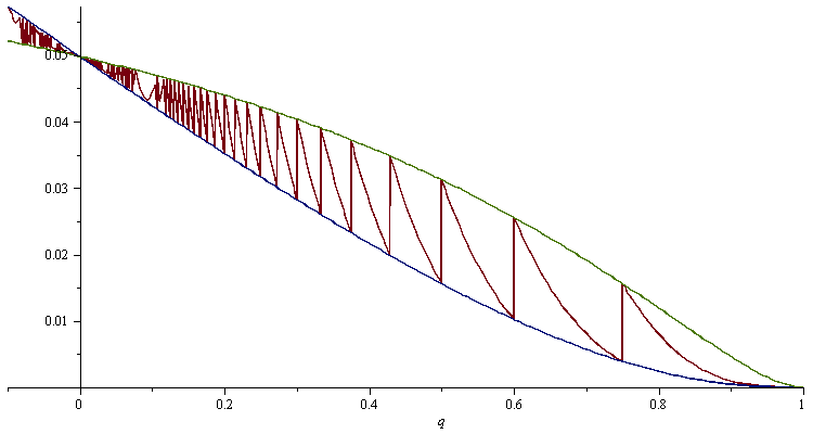

Thanks a lot for the help. I solved it now.
Plot of a red sawtooth-like curve against q from 0 to 1, lying between a blue upper curve and a green lower curve that both rise from about 0.95 at q=0 to 1 at q=1; y-axis runs from 0.94 to 1.
Plot of a red sawtooth-like curve against q from 0 to 1, lying between a green upper curve and a blue lower curve that both decrease to zero at q = 1; y-axis runs from 0 to 0.05 and the red curve has vertical drops near q = 0.75, 0.6 and 0.43.
The red graph is the probability. The other two are the bounds of the floor function. The level is then 0.05.
The plots helped me understand it and gave the hint sense.
