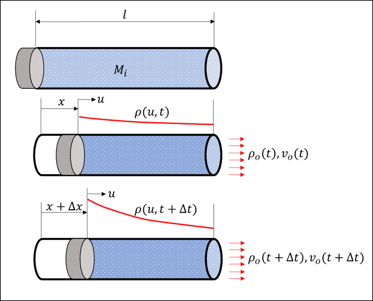

I'm trying to figure out how the mathematics of conservation of mass in compressible flow works for a simple setup. I posted this problem in hw physics section, and the conversation turned to the physics model and appears to have gone kaput. This was supposed to be a mathematics question (but its difficult to untangle completely from the physics), so it went to the wrong forum.
In the top position the system is static. The mass of air in the pipe at ##t=0## is ##M_i##, then the piston starts to advance pushing air out of the outlet ##o##. The density ##\rho## of the flow across the remainder of the tube will vary in the coordinate ##u##, and time ##t##. the origin of ##u## is to ride along with the piston and will always range from ##0 \leq u \leq l-x(t)##.
The properties ( density and velocity) are distributed uniformly across any particular section ( I'm ignoring realities of what the flow properties look like in transverse directions)
With the subscript ##o## referring to the properties at the fixed location of the outlet. At any fixed time ##t## to get the mass inside the control volume I get that:
$$ M_{cv} = \int_0^{u(t)} A~ \rho (u,t)~du $$
Also, at any time ##t## the rate of change of mass in the control volume is:
$$ \frac{d}{dt}M_{cv} = - A \rho_o(t) v_o(t) $$
So it seems (to me) like I can combine those two equations:
$$ \frac{d}{dt} \left( \int_0^{u(t)} A~ \rho (u,t) ~du \right) = - A \rho_o(t) v_o(t) $$
Now, ##u(t)## ( the upper limit of integration on the LHS) at any fixed time ##t## can be found from the position of the piston w.r.t. to origin:
$$ u(t) = l- x(t) = l - \int_0^t \dot x ~dt $$
My question is:
If I haven't already committed mathematical heresy, is there any way to get ## \rho (u,t)## as a function of all the other variables? It seems like the variable of ##u## is trapped in the integral in some kind of partial integration ( I'm out of my depth on the proper nomenclature), because the variable of the integration is not itself a function of time, just the upper limit. I'm all twisted up on this...
Thanks for any help untangling this mess I'm making.
What in your equation prevents all of the gas from moving instantaneously to the end of the barrel and then leaking out slowly at v0(t)?
To keep things simple, you have two unknown functions ρ(u,t) and v(u,t) and one equation so you do not have enough information to solve. All that physics stuff you want to ignore from your previous post is how one goes about remedying the situation.

No. To determine the velocity of the flow at the end of the barrel you need conservation of momentum which means that you need a pressure variable. You also need to define your material so you will need an equation of state.

I shouldn't have to determine the velocity of the flow at the end at this point. I'm only applying conservation of mass. All I need to know is that the properties at the outlet will be some pure function of time ##t##, same goes for the density of the gas at the end. If we can't find ##\rho(u,t)##,so be it. My interest is only in applying the math, I don't want to derail it again with the next steps in the physics model which defines all these functions.
It really is just about uncovering the motivation for the differential form of the continuity equation as some natural extension of what I'm doing:
$$ \frac{\partial \rho}{\partial t} + \nabla ( \rho \boldsymbol v) = 0 $$
Maybe its not there, maybe it is.

Your demand is not reflected in your equations, so things are not solvable as is.

Fine,...forget about solving for ##\rho(u,t)##. I'm trying to see how the differential form of the continuity arises. It's seems reasonably close to what I'm saying, I just can't make the connection in the mathematics.

It should be divergence, not gradient.
The basic idea is that material flows in/out of a control volume with a mass flux. If the mass flux is not spatially constant, net material can be deposited/removed to/from the control volume changing the density.

The issue with your construction is that you are not taking the limit of zero volume and that the two sides of the volume are “different”
Most engineering proofs take a first order taylor expansion of the mass flux on either side of the box and subtract.

I can see that as an issue. My control volume is not a point, I was hoping the distributions would take care of that after differentiating my result somehow. Perhaps that is a fools errand.
Here’s a quick derivation for a unit volume ##\Delta x \Delta y \Delta z## for flow u in the x-direction
msubscript are per unit time. I am doing a first-order Taylor expansion around the center of the box
##\dot m = m_{in}-m_{out}##
##\frac {\partial \rho} {\partial t}\Delta x \Delta y \Delta z= (\rho u+\frac {\partial (\rho u)} {\partial x}\frac {-\Delta x} 2)\Delta y \Delta z -( \rho u + \frac {\partial (\rho u)} {\partial x}\frac {\Delta x} 2))\Delta y \Delta z##
##\frac {\partial \rho} {\partial t}\Delta x = (\rho u+\frac {\partial (\rho u)} {\partial x}\frac {-\Delta x} 2) -(\rho u + \frac {\partial (\rho u)} {\partial x}\frac {\Delta x} 2)##
##\frac {\partial \rho} {\partial t}\Delta x = - \frac {\partial (\rho u)} {\partial x}\Delta x##
##0=\frac {\partial \rho} {\partial t}+\frac {\partial (\rho u)} {\partial x}##
You can also take my first equation and then do the integral formulation. You can then use the divergence theorem to change the surface integral to a volume integral.

Why should we expand about the center of the element, as opposed to either face? My textbook makes it a point to do this also, but it doesn't seem to be mathematically necessary?
Those are subtleties I have long forgotten. I did it because I wanted ##\frac {\partial \rho} {\partial t}## in the center. Since I am using the zeroth order Taylor expansion for it, I agree that it doesn’t seem to matter. I’ll check a couple of books tomorrow to see if they say anything.
While not answering your question, I noticed that ##-(\rho u|_x -\rho u|_{x+\Delta x})/\Delta x## is the definition of the derivative without the Taylor expansion stuff. I will still look for info about left, center or right definitions.

I think the least arguable way is the approach I described in post 15.
So I gather that to actually solve this problem we are going to be working with the Navier Stokes equations.
It depends on what specifically you are trying to do. For compressible flow, you generaly start with the conservation equations with an equation of state. There are simplifications if you are dealing with shocks or are in the acoustic limit.
