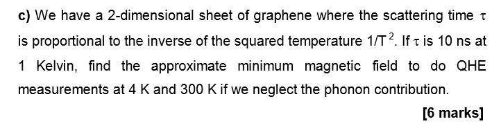

Please see below.
3. The Attempt at a Solution
The idea is to find Bmin. We know: $$
\tau \frac{eB}{m}\gg 1 \\ \\
\rightarrow \frac{eB}{m}\gg \tau$$
Points:
[1] We are given $$\tau \propto \frac{1}{T^{2}}$$ .
[2] We are also given a conversion factor $$\tau =10ns \ at \ 1K$$.
Now, how would you use [1] and [2] to convert 300K?
I'm assuming you can't just use [2] and do $$300K\cdot \frac{10ns}{1K} = 3X10^{-7}s$$ because of the non-linear relation given in [1].
Am I just confusing things?
You are told that [itex]\tau = CT^{-2}[/itex] for some constant [itex]C[/itex], and are given sufficient information to determine [itex]C[/itex].
Ahhh, don't know why I didn't think of it like that! Many thanks!
