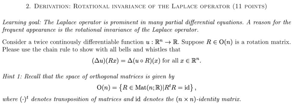

prove ##\Delta## is rotation invariant.
##\Delta##
Hello, please lend me your wisdom.
##\Delta u=\partial_{x1}^2u+\partial_{x2}^2u+...+\partial_{xn}^2u##
##Rx=\left<r_{11}x_1+...r_{1n}x_n+...+r_{n1}x_1+...+r_{nn}x_n\right>##
##(\Delta u)(Rx)=(\partial_{x1}^2u+\partial_{x2}^2u+...+\partial_{xn}^2u)\left<r_{11}x_1+...r_{1n}x_n, ...,r_{n1}x_1+...+r_{nn}x_n\right>####u\circ R=##
##\begin{pmatrix}
(u)r_{11} & ... & (u)r_{1n} \\
(u)r_{n1} & ... & (u)r_{nn}
\end{pmatrix}##
##u\circ R x=\left<(u)r_{11}x_1+...(u)r_{1n}x_n+...+(u)r_{n1}x_1+...+(u)r_{nn}x_n\right>##
##\Delta u\circ R x= (\partial_{x1}^2+\partial_{x2}^2+...+\partial_{xn}^2)\left<(u)r_{11}x_1+...(u)r_{1n}x_n+...+(u)r_{n1}x_1+...+(u)r_{nn}x_n\right>=##
##(\partial_{x1}^2u+\partial_{x2}^2u+...+\partial_{xn}^2u)\left<r_{11}x_1+...r_{1n}x_n, ...,r_{n1}x_1+...+r_{nn}x_n\right>=(\Delta u)(Rx)##
I think ##u\circ R## does not mean ##(u) (R)## and I just showed the same calculation twice. How do I use the information ##R^{-1}=R^T## to prove this case?
Let us take z-axis as axis of rotation of angle ##\alpha## and take cylindrical coordinates or spherical coordinates. For the rotation
[tex]\phi'=\phi + \alpha[/tex]
, we get rotation invariance of Laplacian because
[tex]\frac{\partial^2}{\partial \phi^2}=\frac{\partial^2}{\partial \phi'^2}[/tex]
