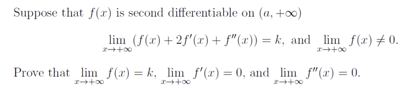

I imagine ##f(x)## has horizontal asymptote at ##x=k##. Since the graph of ##f(x)## will be close to horizontal as ##x \rightarrow \infty##, the slope of the graph will be close to zero so ##\lim_{x \rightarrow \infty} f'(x) = \lim_{x \rightarrow \infty} f^{"} (x) = 0##
But how to put it in mathematical way? Thanks

The first thing I'd do is look for a counterexample. Did you think of that?
I have no idea why this should be true and I don't believe it. That's my starting point.

Do you mean ##y = k##? You cannot have ##x = k## and let ##x \to \infty## at the same time.
Edit: And yes, as @PeroK hints at - you should first make sure that there are no obvious counter examples before you set out to prove something.

What I did was thinking which function is possible to have horizontal asymptote, I think about rational function and exponential function and those 2 functions fulfill the conditions in the question.
As for counterexample, nothing come to my mind to prove the question is wrong and also to prove my statement in OP is wrong. I think about polynomial graph, trigonometry, square root, logarithm but none of them satisfy ##\lim_{x \rightarrow +\infty}=k##

I would also note that the question you are asked in the picture is very different from your statement in the OP.
You mean the question asks to prove ##\lim_{x \rightarrow \infty} f(x)=k## while I assume it is true without proving it?
Thanks
songoku said:
Both do not satisfy the conditions given by the question. Is this supposed to be the counterexample?
It is a counter example to your statement in the OP where you are trying to prove that the limit of f’(x) is zero if the limit of f(x) is k.
songoku said:
You mean the question asks to prove limx→∞f(x)=k while I assume it is true without proving it?
Yes, you need to prove it, not assume it. Furthermore, the condition given by the question is more restrictive than your assumption.

First, I have to say that this problem may be significantly beyond your abilities at this stage. I think you don't even understand what the question is asking. We could try a simpler question to try to explain what you are being asked.
Suppose we have a function ##g(x)## such that ##\lim_{x \to \infty} g(x) = a##, where ##a## is a real number. I.e. the limit exists and is finite. Now, suppose that ##\lim_{x \to \infty} g'(x) = b##, where ##b## is also a real number. Then we can prove that ##b = 0##. That might be something you could try to prove.
However, it's not necessarily the case that ##\lim_{x \to \infty} g'(x)## exists. The above function is an example of this.
Now, here's the idea. Could we find a function ##g(x)## such that neither ##\lim_{x \to \infty} g(x)## nor ##\lim_{x \to \infty} g'(x)## exist and yet: ##\lim_{x \to \infty} (g(x) + g'(x))## exists and is finite?
That might be an easier problem to think about. In other words, either prove that:
If $$\lim_{x \to \infty} (g(x) + g'(x)) = k$$ then $$\lim_{x \to \infty} g(x) = k \ \ \text{and} \ \ \lim_{x \to \infty} g'(x) = 0$$Or, find a counterexample.
I also have the same thought. I don't even know what is the starting point to solve this question. L'Hopital can not be used because the form is not ##\frac{0}{0}## or ##\frac{\infty}{\infty}##, Taylor expansion can not be used so I tried derivative from the first principle and got:
$$\lim_{x \rightarrow \infty} (f(x)+2f'(x)+f"(x)=k$$
$$\lim_{x \rightarrow \infty} \left(f(x)+2 \lim_{h \rightarrow 0} \frac{f(x+h)-f(x)}{h}+\lim_{h \rightarrow 0} \frac{f'(x+h)-f'(x)}{h} \right)=k$$
But I don't think this is the correct approach.
Let me rephrase the question:
Prove that if ##\lim_{x \rightarrow \infty} (f(x)+2f'(x)+f"(x)=k## and ##\lim_{x \rightarrow \infty} f(x) \neq 0## then ##\lim_{x \rightarrow \infty} f(x)=k## , ##\lim_{x \rightarrow \infty} f'(x)=0## and ##\lim_{x \rightarrow \infty} f"(x)=0##
Do I interpret the question correctly?

You need something more formal than that. The basic idea is that if ##g'(x) \to b##, where ##b \ne 0##, then ##g(x)## must eventually be changing steadily and cannot itself tend to a finite limit. You can formalise this using the ##\epsilon-\delta## definition.

This statement is nonsensical. You cannot differentiate with respect to x after taking the limit ##x \to \infty##.

You can obtain examples of functions satisfying [itex]f''(x)+ 2f'(x) + f(x) \to k[/itex] by solving the (linear, constant coefficient) ODE [tex] f'' + 2f' + f = g(x)[/tex] where [itex]g[/itex] is any function such that [itex]g(x) \to k[/itex]. Thus you can obtain examples of monotonic tendency to [itex]k[/itex] such as [tex]g(x) = k(1- e^{-x}), \qquad f(x) = Ae^{-x} + Bxe^{-x} + k(1 - \tfrac12x^2e^{-x})[/tex] or oscillatory tendency such as [tex]g(x) = k + e^{-x}\sin x,\qquad f(x) = Ae^{-x} + Bxe^{-x} + k - e^{-x}\sin x[/tex] where setting [itex]A = B = 0[/itex] gives an [itex]f[/itex] which does not have a horizontal asymptote.
In answering the actual question, it may assist you to make use of the fundamental theorem and a basic property of integrals that if [itex]g(x) < h(x)[/itex] for all [itex]x > R[/itex] then for all [itex]x > R[/itex], [tex]\int_R^x g(t)\,dt < \int_R^x h(t)\,dt[/tex] in order to find a lower bound for [itex]f[/itex] which tends to [itex]+\infty[/itex] if it is given that [itex]f'(x) \to b > 0[/itex], and to find an upper bound for [itex]f[/itex] which tends to [itex]-\infty[/itex] if it is given that [itex]f'(x) \to b < 0[/itex].

songoku, it turns out that the desired proof can be written in just a few lines using an old trick due to mathematician G.H. Hardy, namely: multiply and divide ##f(x)## by ##e^{x}## and then use L'Hospital's rule to evaluate the limit.
Here are some hints to get you started: observe that ##f(x)+2f^{\prime}(x)+f^{\prime\prime}(x)=\left(e^{x}f(x)\right)^{\prime\prime}/e^{x}## and note that the limit can be rewritten as ##\lim_{x\rightarrow\infty}f(x)=\lim_{x\rightarrow\infty}\frac{e^{x}f(x)}{e^{x}}##. Keeping the first hint in mind, apply L'Hospital's rule twice to the right side and take the limit. Repeat the same trick with only one use of L'Hospital's rule and calculate the limit again. What can you conclude from the two expressions you get for this limit?
Note that what you will have proved is a version of Barbalat's Lemma:

I mean, the pattern of note here is the coefficients 1-2-1, which should be recognisable as the binomial coefficients of of 2c2, 2c1, 2c0. Because of this, you can kind of sort of get at rewriting the expression as something that includes ##f(x)## and a function that is directly proportional to its own derivative. In particular, it holds that
\frac{d^n}{dx^n}(f(x)g(x)) = \sum_{k = 0}^n {n \choose k} f^{(k)}(x) g^{(n-k)}(x)
and so, if ##g'(x) = \alpha g(x)## (i.e., ##g(x) = e^{\alpha x}##) then
\frac{d^n}{dx^n}(f(x)g(x)) = g(x) \sum_{k=0}^n {n \choose k} \alpha^{n-k}f^{(k)}(x).
In particular, for ##n = 2## you would have
\frac{(f(x)g(x))''}{g(x)} = \alpha^2 f(x) + 2\alpha f'(x) + f''(x),
which is equal to the original expression if ##\alpha = 1## (just keeping ##\alpha## general to note that other possibilities exist).
However, the big question is: Can you complete the proof with the hint that was given?
