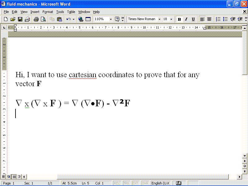

Can someone help me with this proof
  • Screenshot of a Microsoft Word document showing typed text: "Hi, I want to use cartesian coordinates to prove that for any vector F", followed by the identity ∇ x (∇ x F) = ∇ (∇•F) - ∇²F.

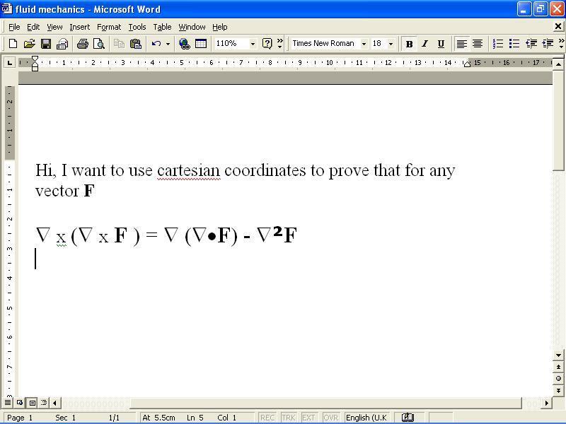

  • Screenshot of a Microsoft Word document showing typed vector identity: curl of curl of F equals grad of div F minus laplacian of F, written with nabla symbols.

Well, Cartese away first, and we'll help you if you stumble! :smile:
I would recommend starting by supposing F is made up by three components, F_1 , F_2 ,F_3 then just expand out the left hand side!
It is tidous but you will see it will fall out
