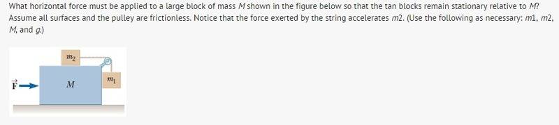

Pulley Problem: Keeping boxes stationary on another box
The discussion revolves around a physics problem involving a pulley system with multiple masses, specifically focusing on keeping boxes stationary on another box. The participants explore the dynamics of the system, including forces acting on the masses and the relationship between acceleration and tension in the string.

##F_{net} = ma##
If ##m_2## accelerates, then the force on this box is ##m_1g## and its acceleration is ##\frac{m_1g}{m_2}##. If I disregard the presence of ##m_1## for a minute, I'll have to push on ##M## with a force such that its acceleration is the same to that of ##m_2##. And I'll need to push two masses: ##M## and ##m_1##, so ##F = (M+m_1)\frac{m_1g}{m_2}##.
I'm not sure whether this conclusion is correct. ##m_1## has a downward acceleration and a horizontal force ##F## cannot prevent it from falling; unless there is friction between ##M## and ##m_1##. On the other hand, if a push on ##M##, by Newton's First Law ##m_2## will attempt to remain at rest, which is the same as exerting a force ##F## on ##m_2## in the opposite direction and ##M## remaining at rest. Since I want the smaller boxes to remain stationary, my problem is reduced to one where I need to counteract the force making them move, hence ##F## would have to be ##m_1g##.
What is the correct approach?

Well, I see that my system is the three masses together.
If I'm not wrong again, the acceleration I need to provide to my system is ##\frac{m_1g}{m_1 + m_2}##. The force would have to be:
##(M + m_1 + m_2)\frac{m_1g}{m_1 + m_2}##

What is the vertical acceleration of ##m_1##?
##g##
Doc Al said:
What is the net vertical force on ##m_1##?
My new attempt [: :
If there is no motion of ##m_1##, ##F_{net} = 0##, and tension has the same magnitude that ##m_1##'s weight. Here that doesn't happen, so:
##F_{net} = m_1g - T##

The vertical acceleration of ##m_1## is 0, not g!
Jazz said:
My new attempt [: :
Good! (Remember: This tells you what T is.)
Jazz said:
The force is ##m_1g##
Good. Don't forget this.

This is where you are missing the point. You have two vertical forces on ##m_1##. As m_1 is not accelerating in this direction they are balanced. So, you know the tension.
Now, turn your attention to the forces on ##m_2##. How many horizontal forces are acting on ##m_2##?

This is the one you want, but don't complicate things. What does ##F_{net}## equal? (We've gone over this before, and you had it right, but for some reason you keep dropping it.)
The ##F_{net}## I want has to be zero.
Doc Al said:
Using just this last equation, tell me what the tension must equal? Nothing complicated. (Again, you had solved for the tension long ago, but dropped it.)
Tension has to be equal to ##m_1g##.
Good. Now that you have the rope tension, it is time to analyze the forces on ##m_2## and apply Newton's 2nd law.
Do that.
On ##m_2##, the vertical forces are in balanced. There is no friction between the surfaces so only the tension, pulling it to the right, is my ##F_{net}## there:
##F_{net} = T##
##m_2a = m_1g##
My acceleration has to be: ##\frac{m_1g}{m_2}##.

Perfect. Now you have the acceleration. Now you can find F.
Since my system are the three boxes (and there is no friction on the floor either), my force ##F## has to be:
##F = \small{(M + m_1 + m_2)}\frac{m_1g}{m_2}##
It doesn't look that bad, does it?
Perfecto! :)

The picture I had in mind is that that I wrote before: both boxes on ##M##, touching each other with a force ##m_1g## to the right.
Maybe this was making me miss the fact that the horizontal force on ##m_2## does not affect the vertical force on ##m_1## (under the absence of friction or any other opposing force). Then, if I don't exert the force ##F##, ##m_1## will move downward at ##9.8\ m/s^2## and ##m_2## to the right at ##\frac{m_1g}{m_2}##.
Somehow I was thinking that having to pull ##m_2## was making ##m_1## to move downward at an acceleration less than ##g##, as my mental picture was suggesting.
Have I discovered where I've been getting trapped all the time? I think so.
