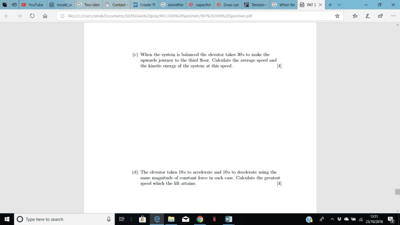

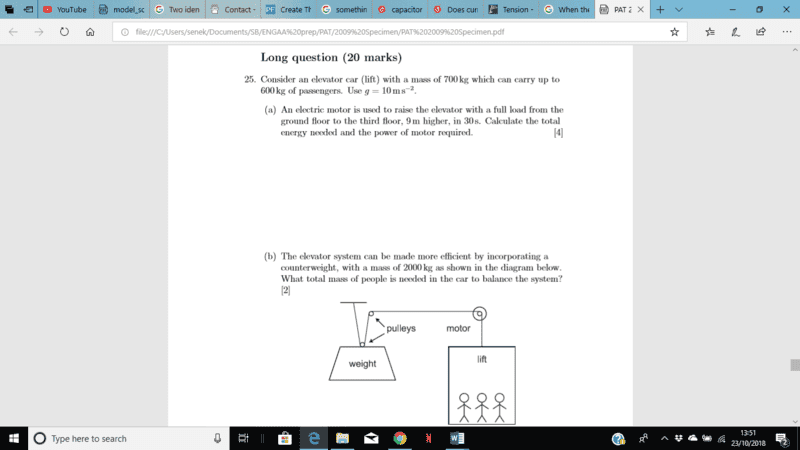

Part c)
I'm confused as to how the actual pulley system works. If its balanced wouldn't it be stationary. How does it move?
I thought that since its balanced the acceleration of the system is constant and therefore to find the average kinetic energy of the system, I would just do 1/2 x (2000 + 1000) x (9/30)^2
The answers say that the weight only moves half as far. How do you know this?
I believe by "balanced" they mean that the net force is zero.
Note how the cable attaches to the weight. When the weight moves down by 1 unit, how much cable must move through the pulley above the car? (You might want to play around with a piece of string to better visualize what happens.)
