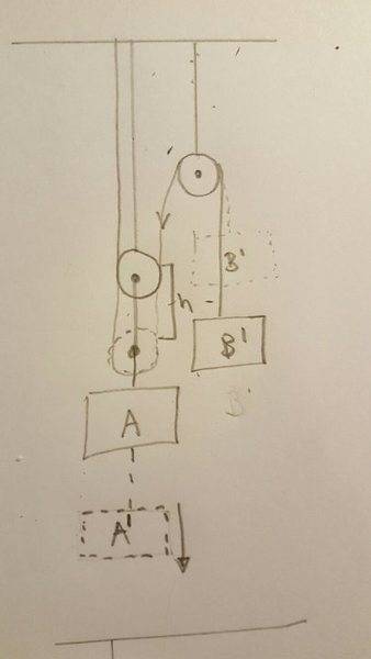

I drew a diagram.What I know. Left part of rope is fixed to ceiling so extra rope comes 'from the right' i.e. 'falls down' as pulley is pulled. I also know that rope is conserved.

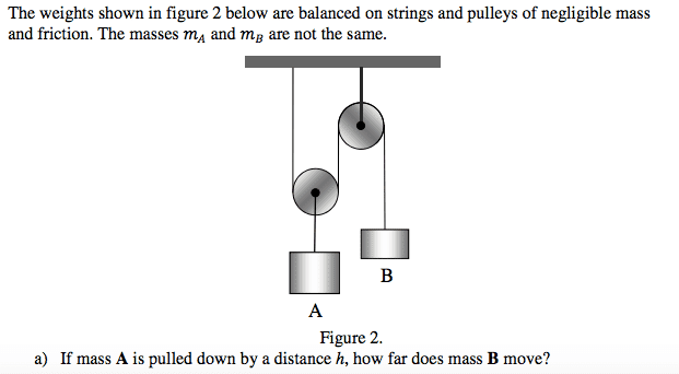

This problem's solution is 2h, but I don't understand how?
Why don't you make a sketch? Remember, the left-most line is fixed to the ceiling. Where must the extra rope come from when the left sheave is pulled down?

You had help for your first thread, and apperently now for your second too, but still...[hint] How much does A go up when B moves down 2h ?

BTW, the distance sheave A would travel would be the same, regardless of whether a mass was attached. This problem is about conservation of the rope which runs between the sheaves, not about energy or any other such phenomenon.
Think about why a pulley system is considered a machine and where its mechanical advantage comes from.

For some reason, you have blocked out of your mind how the shaves are going to move at all by changing the lengths of the different parts of the rope running thru them. Remember, it's a single piece of rope connecting the ceiling to mass B. If you tug down on mass A by a distance h, can either of the two parts of the rope holding up this mass not change their length relative to the sheave supporting mass B?
Well the part on the left (supporting A) goes 'up' h and the part on the right 'down' h? So the rope as a whole 2h? :woot:
Hebel said:
Well the part on the left goes 'up' h and the part on the right down 'h'? So the rope as a whole 2h? :woot:
If you're pulling down on mass A, the two parts of the rope supporting mass A must lengthen by the same amount. When this occurs, what happens to mass B?
B rises by 2h right? Is that because, if one lowers A by h the one part of the rope supporting A needs to gain a length of h and the other part does as well...? I lack experimental experience with this, are there any animations/experiments/resources you know of?
Yes.
