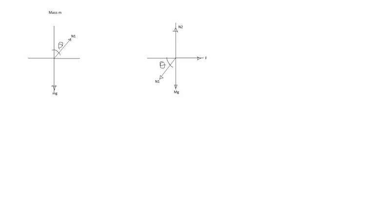

This seems to be a slight variation of a pretty standard problem, however I didn't have any luck finding any seemingly helpful information. I am mainly wondering if I am not getting the FBDs correct?
A block of mass [itex]m[/itex] is sitting on a movable ramp of mass [itex]M[/itex] with an incline of [itex]\theta[/itex] degrees to the horizontal. The system is initially held at rest. Once released, a force, [itex]F[/itex], pushes the vertical side of the ramp such that the block accelerates upward along the incline. There is no friction anywhere; Write an expression for the force.
[itex]\sum \text{F} = ma[/itex]
The FBD's are in the attached image.
I seem to be arriving at a system with one more variable than equations, so I am definitely not understanding something, and I believe it has to do with the FBD? Here is what I come up with:
As the inclines acceleration ([itex]a_{\text{I}}[/itex]) is purely on the horizontal plane, then the components of the blocks acceleration ([itex]a_B[/itex]) are:
[itex]a_x = a_{\text{B}}\cos \theta - a_{\text{I}}[/itex] and [itex]a_y = a_{\text{B}}\sin \theta[/itex].
for the little mass, m:
[itex]\sum \text{F}_x = N_1 \sin \theta = m(a_{\text{B}} \cos \theta - a_{\text{I}})[/itex]
[itex]\sum \text{F}_y = N_1 \cos \theta - mg = ma_{\text{B}}\sin \theta[/itex]
and for the incline:
[itex]\sum \text{F}_x = \text{F} - N_1\cos \theta = a_{\text{I}}M[/itex]
I'm pretty stuck and have no idea what it is that I'm missing, so I would really appreciate it if someone could give me a hint.
Forgot to include the FBD.
[edit] The rightmost FBD is for the incline.

I think that I may have stated the problem in an unclear way. So the incline is resting on the ground and the force is pushing it along the horizontal and there is no rotation in the ramp. I want to find an expression for the magnitude of the force so that the block slides up the ramp leftward as the ramp slides to the right.

Oh, ok. I thought the ramp was moving upward, not rightward. So initially, you can just look at the acceleration of the ramp, and see what conditions need to be met in order for the block to move upward.
Can you tell me what these are? Basically you have force of Earth on block and force of ramp on block.
Hint* think components or rotate your axes.
Maybe a better question would be which way should the net force be directed?
Are you trying to find the minimum value of F to accelerate the mass up the incline?
Well, if I draw the acceleration vectors for the block and the incline - the block with respect to the incline is up and to the left and the incline with respect to the ground is only to the right - then the resulting acceleration vector for the block with respect to the ground is up and to the right. That would then be the direction of the net force, no?

If we are finding the maximum force with which to push the incline so the block has no vertical acceleration, then the block/ramp system is one mass with only one acceleration in the positive x direction, so i get [itex]\text{F}=m_Ta = (m+M) a \implies a = \text{F}/(m+M)[/itex]. So now we only need consider the forces on the block,
$$\sum \text{F}_x = N(\sin \theta - \mu_s \cos \theta) = ma\;\;\;\;\;\;\;\;\;\;\;\;(1)$$
$$\sum \text{F}_y = N(\cos \theta + \mu_s \sin \theta) - mg = 0 \;\;\;(2)$$
so dividing (1) by (2) and substituting in a, I get my answer.
