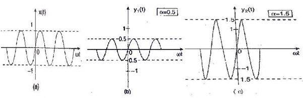

Suppose 3 1D Signals x(t), y1(t) and y2(t) are given as
x(t)=sin(40*pi*t);
y1(t)=.5*sin(40*pi*t) and
y2(t)=x(t)+y1(t).
Left side =Right side
Here,values of x(t)and y1(t)i.e.(Right side) are given and we get y2(t)(Left side).The plots of x(t),y1(t) and y2(t)
are plotted below
Now,in the next case,suppose left side is given and we are to asked to find right side.But the twist is that here signal not 1D .It is 2D i.e an image! shown below
I know that image consists ofsummation of thousand of signals but here I want to see plots of only 4 to 5 signals from the image (like of x(t) and y1(t) shown above) but not the whole spectrum. How it can be done?

I don't understand the question. You want to add two different things, and in the 2D case you know the sum but not the summands? That is impossible, independent of dimensions.
The sum of two integers I thought of is 12, what are the integers? -> no way.
You can find specific ways to split the function into components, but then you need additional constraints on those components.

This is the second post of yours I've seen, and I think you're not understanding something about Fourier transforms. A Fourier transform takes a function like f(t), and a set of orthogonal basis functions or vectors that have f(t) as a linear combination thereof, and finds what scalars need to multiply each of these to make that work and returns those.
So suppose you want a computer program that takes a Fourier transform of some vector (1D) and only looks at certain frequencies in it, but discards the rest. What you do is take the full DFT (or FFT) of the vector, then you multiply all the frequencies you don't want by zero, and then take the inverse transform, usually called ifft or something like that. What you will see in the plot you get back is the sum of a couple sinosoids, whatever frequencies you didn't multiply by 0. Its that easy.
To know what frequencies you are dealing with based on their position of the output array of the FFT, look at the definition of the DFT matrix:
http://en.wikipedia.org/wiki/DFT_matrix
Now with a 2D image, you have to be clear about what you want. Its 1D FTs in each direction, but it all adds up nicely so the gist of it, as I recall, is that the lower frequencies are in the center of the image. For a square image 1000 by 1000, you could multiply all but a 10*10 square in the middle by zero, and you would see only the low frequencies that make up the image when you inverse transform it for instance. You could also then remove a 4*4 ring in the middle of that center square to rid yourself of the two lowest frequencies (I believe), and isolate whatever frequencies you want using that general idea.

Sir in the equation y2(t) is summation of x(t) and y1(t) .so whether x(t) and y1(t) are called as bases functions here? I am confused by the term "bases function"
No. You said:
x(t)=sin(40*pi*t);
y2(t)=x(t)+y1(t).
So I know y2(t) = 1.5 sin(40*pi*t)
Basis functions/vectors would have a different frequencies, like if y1(t)=sin(20*pi*t). I can explain more if you have taken Matrix math, but really until you can clearly state what you are asking, there is no question for me to answer.

ok.fine.lets concentrate on 1D and keep aside 2D for some time.
Suppose there are 3 1D signals x(t),y(t) and z(t) such that equation x(t)=4*sin(10*pi*t) and y(t)=8*cos(20*pi*t).
Also, z(t)=x(t)+y(t) .
here,will you tell about concept of "bases function" in 1D signals . Also,for z(t) what are bases function.?
Further ,I know matrix operations .so you can extend the above concept of bases functions from 1D to 2D by taking any simple example( of 2D signal) of your choice for understanding.Thank you :-)
Sure, by taking the Fourier tranform of z(t), we can detect the fact that it is the sum of x(t) or y(t), and deduce x(t) and y(t) from z(t).

No, for discrete Fourier transform, the basis functions would define like the rows of the DFT matrix. What you'll find in Matlab are functions fft(v) and ifft(v), which essentially multiply the input vector v with the DFT matrix, or its inverse (for ifft). To learn the functions/basis vectors behind the DFT matrix you need to look at its definition:
http://en.wikipedia.org/wiki/DFT_matrix#Definition
