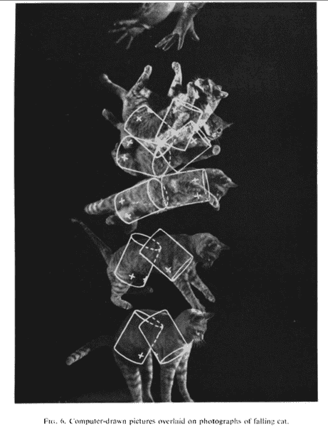

And here's a graphic:
This image is from TR Kane's and MP Scher's seminal paper on the subject, A dynamical explanation of the falling cat phenomenon. Thomas R. Kane is no slouch. Study robotics and you will inevitably learn about Kanes' dynamics equations. He is in a sense the father of modern robotics.
This is Kane's two-parts-cat model animated:
https://www.youtube.com/watch?v=yGusK69XVlk
A human standing on frictionless surface could try the same (basically a hula hoop swing), but would probably fall over. Swinging arms seems better here.
