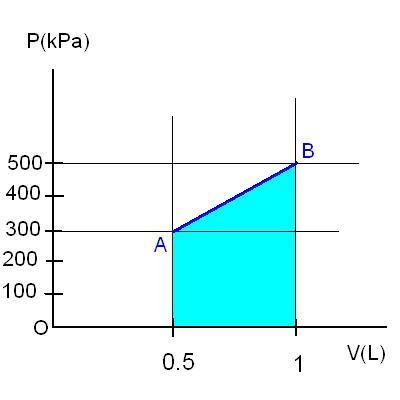

Imagine a graph of pressure in kPa (y-axis) against volume in L (x-axis). There is a straight line moving from point A at 300kPa, 0.5L to point B at 500kPa, 1L. The false origin on this graph is 200kPa, 0L. What is the work done by the gas?
W=pV
I know that work is area under graph so its basically the area of a triangle plus area of trapezium. But this gives work = 100J but textbook says 200J. Where have I gone wrong?
See the picture . You need the blue area from the really zero pressure.
ehild
  • P-V graph with P in kPa on the vertical axis and V in L on the horizontal axis. A straight blue line runs from point A at 300 kPa, 0.5 L up to point B at 500 kPa, 1 L, with the area under it shaded cyan down to the axis.

Use the formula for area of a trapezoid: (L1 + L2)/2 x W
AM
Andrew Mason said:
Use the formula for area of a parallelogram: (L1 + L2)/2 x W
AM
You meant trapezoid, I think :smile:
ehild
