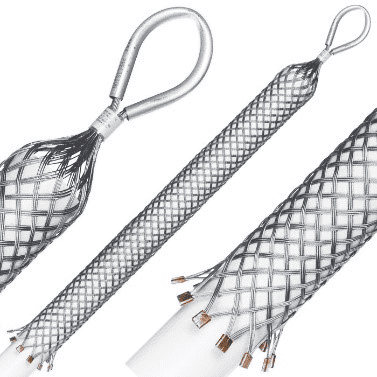

When we first moved into our house, construction was working on our street. The crew showed us a leak in the mains running from the street. They offered to fix it on-the-spot by attaching a metal mesh grippy thing to the copper line and used a backhoe to brute strength the old line out length-wise and pull the new line through. They charged us 700 bucks and it has been leak-free for 25 years.
I have never heard of this "wire mesh" idea for pulling pipe - is this material similar to woven wire cloth like this: Woven Wire Cloth which is made of metal (usually stainless steel) or is this plastic or nylon material? The strength must be unbelievable!
Wire mesh pipe pullers also known as Towing Socks, Chinese Fingers or Pulling Grips
And yes, I was pretty impressed myself.
Incredible. Thank you for the information - now down the youtube rabbit hole!!!
