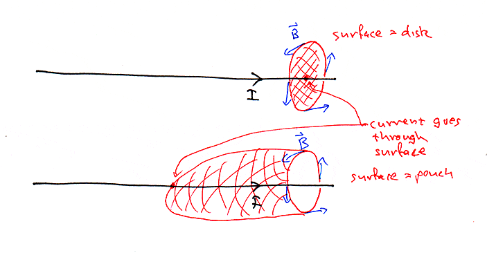

OK, I'm going to assume you've seen simple applications of Ampere's law without the Maxwell "addition", for finding e.g. the magnetic field produced by straight wire. We define an "Amperian loop", integrate B around it, and relate that to the current "enclosed" by the loop: $$\oint {\vec B \cdot d \vec l} = \mu_0 I$$ More precisely, to get the "enclosed" current, we define a surface whose boundary is the loop, and integrate the current density over that surface: $$\oint {\vec B \cdot d \vec l} = \mu_0 \int {\vec J \cdot d \vec a}$$ In a steady-state situation (magnetostatics) it doesn't matter what shape the surface is, so long as it doesn't have any "holes" in it. We get the same current through it regardless of the shape, and the same B field around the boundary.

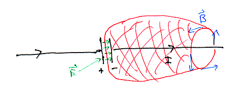

Now suppose we put a capacitor in the circuit.
Hand-drawn sketch of a wire with arrow showing current flowing toward a capacitor, with a red mesh-shaded surface spanning between the plates, labelled E and +/- signs, and a blue loop labelled B encircling the wire.
No current actually passes through the surface any more! Instead we have an E field whose magnitude changes as the current dumps charge on one plate and removes it from the other. If we use only the current through the surface to calculate the B field, we get different results depending on the shape of the surface, i.e. whether the current actually "pierces" the surface or not. No good!
We can restore the consistency if we assume that the time-varying flux of E through the surface also contributes to the calculation. Define a new "displacement current" $$I_\textrm{d} = \varepsilon_0 \frac {\partial}{\partial t} \int {\vec E \cdot d \vec a}$$ and add it to the normal "conduction current": $$\oint {\vec B \cdot d \vec l} = \mu_0 (I + I_d)$$ Substituting the definitions of the I's we get the full Ampere-Maxwell law in integral form: $$\oint {\vec B \cdot d \vec l} = \mu_0 \int {\vec J \cdot d \vec a} + \mu_0 \varepsilon_0 \frac {\partial}{\partial t} \int {\vec E \cdot d \vec a}$$ Or in differential form: $$\vec \nabla \times \vec B = \mu_0 \vec J + \mu_0 \varepsilon_0 \frac {\partial \vec E}{\partial t}$$
