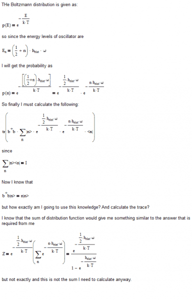

I must find the average number of energy levels of quantum harmonic oscillator at temperature T, and the answer is given as
I must use Boltzmann distribution and the sum of geometric progression. For finding the average value I must use the equation
<F>=trace(F*rho)
Where rho is the density matrix, given as
Where p is the probability and n is the energy eigenstate of oscillator. For F I must use b+b
[/B]

Your expression for p(n) needs to be normalized so that the sum of all probabilities equals 1.
If Amn are the matrix elements of a matrix A, how do you find the trace? If A is the matrix inside of your trace expression, can you find an explicit expression for Amn?
It would be sum ∑Amm over m

For an operator A, how would you express Amm in bra-ket notation?
That would be <m|A|m> . So applying that I think I would get
But still, how to apply b+b to that sum?
I got it wrong, <m|n>=kronecker's delta not unit matrix ... but that means I would lose the sum altogether!

Still wrong, the trace is also sum Σ<m|A|m> over m so in the end it should be the way I showed in the last post. But the question of b+b remains
You have neglected the effect of the operator ##b^{\dagger}b##. You can bring ##b^{\dagger}b## inside your sum over n and let it act on |n>.
That would bring n in front of |n> and I would get the sum:
But this is not geometric progression
Remember, you did not normalize your probabilities. So, your result so far is off by an overall normalization factor ##Z##. The first exponential in your result does not depend on the index n, so you can pull it out of the sum. You are left with$$\sum_{n=0}^{\infty} ne^{-n \beta \hbar \omega}$$ where ##\beta =1/ kT##.
The trick is to note that $$ne^{-n \beta \hbar \omega} = -\frac{1}{\hbar \omega} \frac{\partial }{\partial \beta}e^{-n \beta \hbar \omega}$$.

I get
However, are you sure it is the right result? I can't see how it simplifies to
. Or do I just need some extra normalization?
Edit:
I think according to normalization I should just take
And I can see how it gives me the answer I require ;)
Once you put in your normalization factor for the probabilities, you'll see that you'll get the desired result.
I need to divide the result with Z?
Yes. It's important to understand that your original expressions for the p(n)'s needed to be divided by ##Z##.
