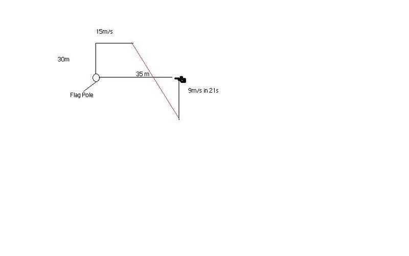

so would this be the right picture and the redline is the displacement?
can't see the picture yet... might be a good idea to post on some image sharing site...
you can try this one:
http://www.imagevimage.com/
kevinf said:
that's not right. you're making it more complicated than it is... just start with displacement... ignore velocity for now...
The initial position is 35m east of the flagpole. The final position is 30m north of the flagpole. What is the displacement?
You should just have a line/arrow from the point 35m east of the flagpole, to the point 30m north of the flagpole.
What is the magnitude of this line? What is the direction?
