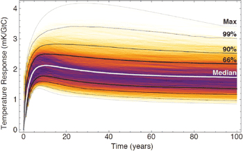

Maximum warming occurs about one decade after a carbon dioxide emission
In the study climate models are evaluated,not with an abrupt doubling of the CO2 level,
but with a 100 GtC pulse. There results show a medium sensitivity 0.2K for the 100 GtC pulse.
The question is if the 100 GtC is pre or post airborne fraction, as in did they inject 100 GtC but then realize
the post airborne fraction of ~44% or 44 GtC, or did they simulate the entire 100 GtC increasing the ppm count?

Top graph (max) after 30 years in the first post. Not sure I understand the data at all though. Could @StatGuy2000 have a quick look?

To @pinball1970 and @256bits ,
I see that you have flagged me with a question regarding the plot above. Are you asking me how to interpret the figure above, or where the quoted value of "~44% or 44 GtC" (from the OP) comes from?
If you are asking me the latter question, ~44 = 1 / 2.2 (where the 2.2 mK/GtC is the median value of temperature response, as per the original source code).
If you are asking me the former question, from my naive look, it appears to me that the simulated model indicates that warming peaks after the 30 year period and then gradually wanes with a steady state of approximately 1.8 mK/GtC after the 100 year period.
Please note: I am not an expert on climate models, nor do I have much experience in the statistical analysis on climatology. So I may not be best qualified to provide much input here.
I think that is just a coincidence.

It goes to the climate sensitivity, it is 0.2K for 100 Gt, that would be a lower sensitivity
compared to 0.2K for a 44 Gt injection.
The graph has a unit of 2.0 per 1000 Gt, so 100 Gt is 0.2.
100 Gt would be an increase of about 47 ppm in the CO2 level,
but 44 Gt would only be 20.6 ppm.
The formulas would look like this is added to todays CO2 level 0.2C /ln(465/418)=1.877,
so 1.877 X ln(2) =1.30C per doubling, vs
0.2C /ln(438.6/418)=4.157, so 4.157 X ln(2)=2.88 C per doubling.
So the difference is sensitivity is quite large.
Yes of course, sorry (corrected).

The conclusion reached in the study is good, because the smaller size emission more closely
resembles how Humans emit CO2, if the average time to maximum warming is about a decade,
then there is minimal warming in the pipeline.
I was attempting to extract the sensitivity from their finding but was had a variable i did not know.
I found the answer to my question, they are not counting the Airborne Fraction, but simulate
a 100 GtC pulse directly increasing the ppm level.
A second Study,
The time lag between a carbon dioxide emission and maximum warming increases with the size of the emission
had a footnote where they discussed the conversion from 100 GtC to ppm
Carbon dioxide and climate impulse response functions for the computation of greenhouse gas metrics: A multi-model analysis
The atmospheric CO2 concentration should be increased at the beginning of year 2015 by 47.1032 ppm (100 GtC/2.123 GtC/ppm) in all atmospheric grid cells.
This defines the sensitivity found in the smaller impulse studies.
