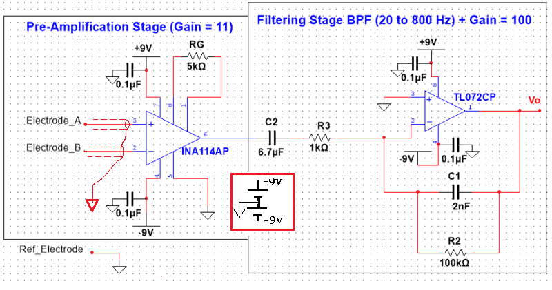

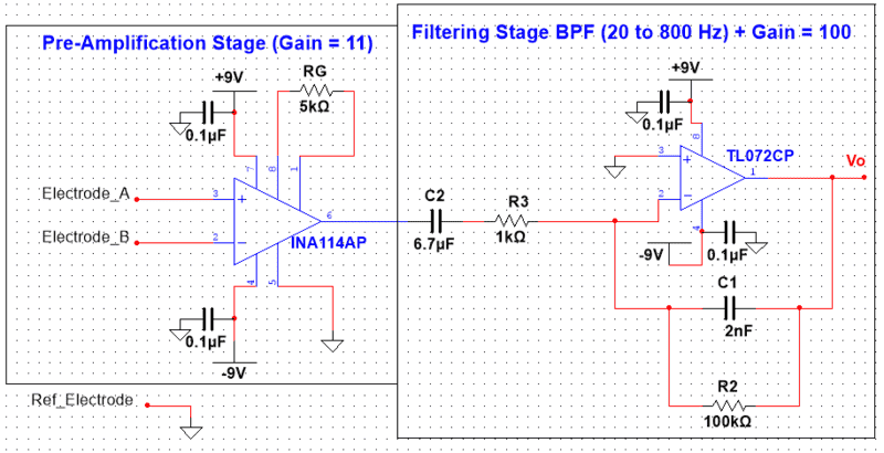

Mo_Tuk said:
i connected the circuit (pre-amplification stage using INA114 + Filtering stage of BPF) and then connected the electrodes to my bicep muscle and try to detect some signal as shown in attached screenshots on the oscilloscope.
berkeman said:
Can you post a diagram of your complete circuit, including the battery power supply, amp circuit, patient connections, and Earth Ground scheme?
Mo_Tuk said:
I connected the circuit exactly as shown in screenshot:
Your circuit that you posted is very confusing for me. I asked to see the circuit that you said you connected to your bicep, but your schematic shows instruments, not a pair of patient connections as input. I also don't see Earth ground, and I see very different biasing compared to your latest differential amplifier questions.
Are you using a single 9V battery for power, or two to give you +/-9V? Please always show your power supply configuration in your schematics. What electrodes were you using to connect to your bicep? What brand, and how old are they? I assume they are single-use disposable, right?
When you flexed your bicep, did you see any response at all out of the amplifier string? It should have been much lower frequency than your 50/60Hz interference.

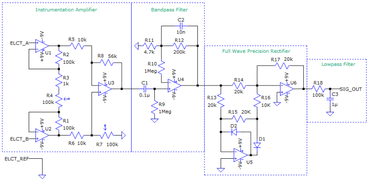

This is more like a circuit diagram that I would expect you to be posting...
https://greenhecktech.files.wordpress.com/2016/09/schematic4.png?w=748

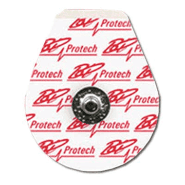

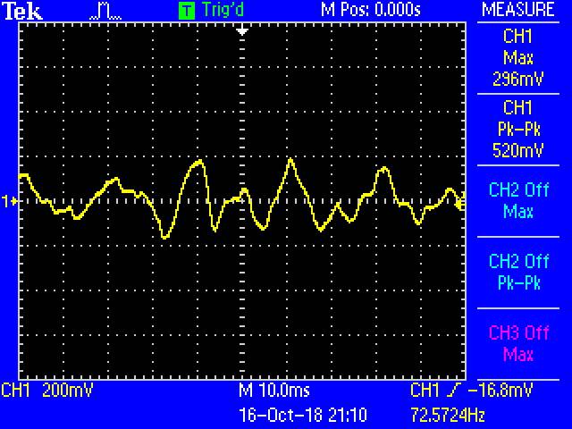

Yes, I'm using two +/-9V batteries to supply the circuit, and I used surface electrodes "BioProtech Electrodes" which shown in attached image.
Although the signal is 50Hz noise but when I flexed my bicep the amplitude increased but the signal still almost the same "50Hz noise"
  • #34
Okay, there are two things that you should approach this with, IMO:
  • You should look more at shielding and balancing your probe lines to cut down on the AC Mains noise pickup -- if you post your full circuit diagram including Earth ground connections and shielding, we should be able to help with that
  • You should consider digitizing the waveform output from your circuit and doing DSP processing to filter out the AC Mains noise. You can do much higher order filters and adaptive filtering with DSP routines. Do you have experience with programming microcontrollers (uCs) in C or Assembly code?
  • #35
Thanks @berkeman
I hope this screenshot of the circuit would be clear, and about the DSP part for now I just want to see clear EMG signal from my bicep muscle and then I will move to programming part using Arduino.
and about the electrode cables would you suggest any specific type of cable that less noise produced ??

Hi Mo_Tuk,
Could you post a photograph of the assembled amplifier and another photograph of showing it connected to you? Please show where the leads connect to you and to the amplifier. With only the wiring diagram, it is very hard for us to guess what may help to get it working.
The waveform you posted earlier (https://www.physicsforums.com/attachments/tek0003-jpg.232273/) looks like there is a DC power supply nearby that is making some electrical noise, maybe a battery charger or computer, or maybe even an LED lamp!
Cheers,
Tom
edit: fixed typo

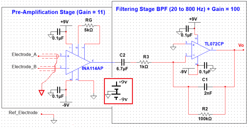

we trust you tied the junction of your batteries to circuit common
and shielded your signal wires
i added those features to your drawing

and about the electrical noise I think the laptop was near to my circuit and plugged into charger.

for the connection you made of electrodes A&B to reference, would that help to reduce noise or something else??

The red dashed lines do NOT represent connections to the electrodes,
instead
they represent shields around the wires bringing signal from the electrodes to your circuit board.
The purpose of a shield is to physically surround the signal wire so the can be no capacitve coupling into it.
Recall from basic physics that no E field can exist inside a closed conducting surface - google "Faraday Shield".
Using a twisted pair to route both signals together will reduce magnetic coupling.
That's why "twisted shielded pair" is so popular.
Your 50 hz noise is probably a combination of pickup that's
capacitively and inductively coupled into the input wires ( and gets amplified 1100X) ,
and
capacitively coupled across the power transformer in your oscilloscope's power supply.
Shielding the input wires will help .
old jim
Emphasizing @Tom.G 's comment"Driven Shield" is a method that's used in precision equipment .
It's shown in the INA111 datasheet
the cylinder surrounding the signal wires represents a shield that is driven to nearly average voltage of the two signals
which minimizes voltage between the shield and signal wires
minimizing capacitive coupling of current into the signal wires.
INA111's input impedance is so high that your signal wires act like an antenna .
Shielding hides them from electric fields by creating a Faraday Cage.
Twisting them reduces their sensitivity to magnetic fields by reducing the area(hence the magnetic flux) they encircle.
That's why we EE's like twisted shielded pair for signal wires..
Try grounding shields first to see if it helps. Driven shield should give even better results.
old jim

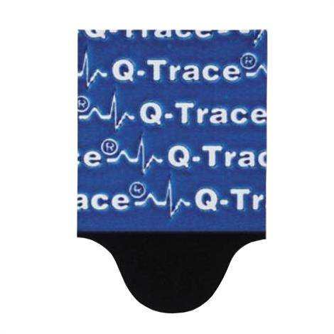

  • #45
Mo_Tuk said:
I have also another type of electrodes (Covidien Kendall Q-Trace Diagnostic Tab Electrodes Resting ECG Electrodes) , is that type better than (BioProtech)?
As long as you are using disposable medical grade electrodes and not something homemade, it should be fine.
  • #46

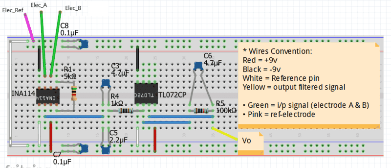

Screenshot of the circuit that I connected on Breadboard, I hope it's clear.

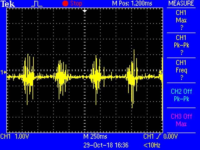

  • #47
This is screenshot of the activity of my bicep muscle (Resting and Contraction)
  • #48
WOW! You did it! Congratulations.
Can you post the details and schematic of what you did?
Cheers,
Tom

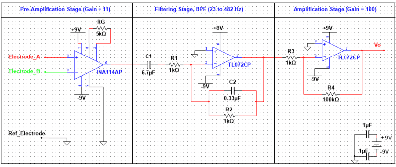

  • #50
The attached image is the schematic for EMG circuit that worked, and I have question about DC level shifter circuit should I add it ??
so that (e.g. the output will be from 0 to 5V max), because Analog to Digital Converter "ADC" of the arduino can only accept this range.
any Suggestion ...
  • #51
For your particular use of detecting different muscle activity you would not need a level shifter.
However the converter on the Arduino board may not like a negative-going signal. I would say try connecting to the Arduino to see if you get reasonable results, if the results are bad then add a level shifter. (Unless of course you want to add a level shifter as part of learning more -- often a good idea. :wink:)
Cheers,
Tom
