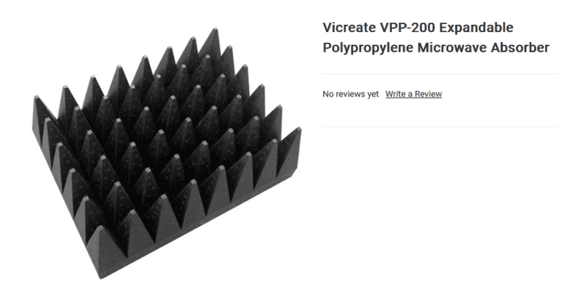

Hello! I have an experimental setup in which I need to send microwaves (MW). I would like to reduce the unwanted scattering of the MW as much as possible and I was wondering what materials are best for this (in vacuum). For example, if I make some holders of metal (e.g. aluminum or steel) I assume they will affect the MW trajectory. If I make them of ceramics for example would that help i.e. do microwave interact with ceramics?

Can you give any more details of the experiment? What band of microwaves and at what Tx level? Are you sure you will be compliant with EMI regulations outside of your lab?
More details would help, but have you looked at EM absorbent cone material to absorb any stray reflections? The material is commonly used in RF anechoic chambers and in places where you want to absorb EM:
https://theemcshop.com/anechoic-cha...-expandable-polypropylene-microwave-absorber/
